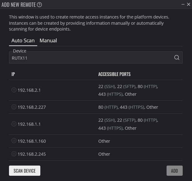

You can access devices through RMS Remote Access using their LAN IP addresses and a specific available port. Here is an example of how it looks:
Accessing devices through an extended URL is not possible.
