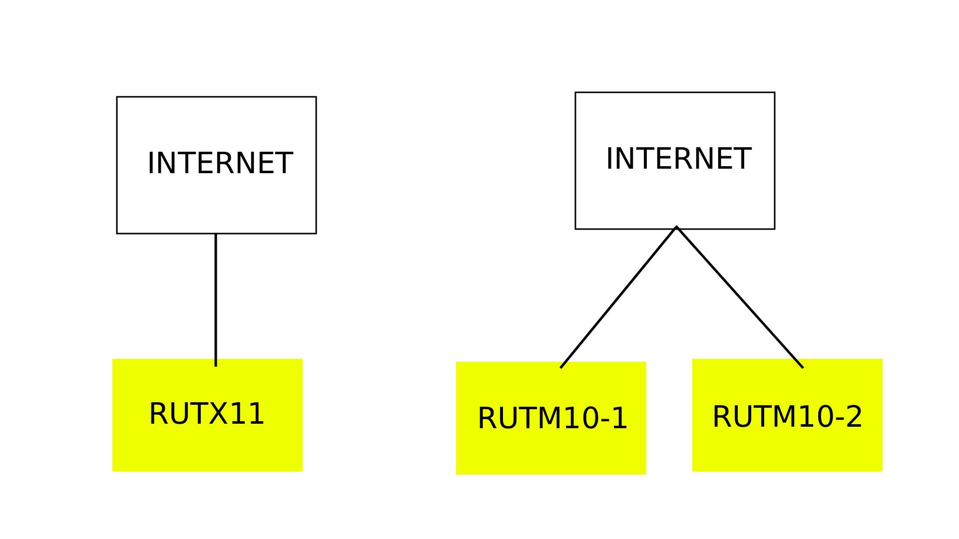

Hello, I’ve created a VPN through RMS with three Teltonika devices: one RUTX11 and two RUTM10s, as well as a user account. I’ve also added the addresses of each router to the routes so I can access them through the VPN.
My question is (according to the diagram): why can I access all the routers from my computer if I’m connected to the internet through RUTM10-1 without connecting with the OpenVPN or Teltonika application on my computer?
If I’m connected to the internet with RUTM10-2 or RUTX11, I have to connect with the OpenVPN or Teltonika application to access the routers.
From the RMS website via WebUI, I can access all the routers while connected to the internet from any router.
I’ve compared the configuration of router rutm10-1 with that of rutm10-2, and it’s practically identical.

Hello, I’ve checked everything you suggested and haven’t found anything wrong. However, the internet connection for devices connected to the router (RUTM10-1) started failing.
I reinstalled the router (RUTM10-1) to its factory settings two or three times, and that solved the connection problem with other routers via VPN, even without being connected. But I was still having internet problems on devices connected to the router (RUTM10-1) until I uninstalled the RMS VPN. I created a new RMS VPN, and all the problems were resolved.
