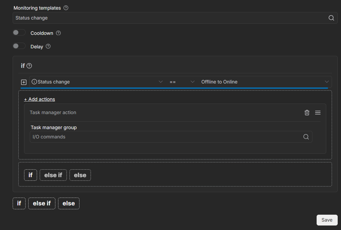

I believe the functionality you are looking for could be achieved using RMS Alerts & Automation (Management → Alerts & Automation). You can configure a rule where the IF condition is that the device status changes from Offline to Online, and then add an action to execute a predefined Task Manager action with the required input/output commands:
