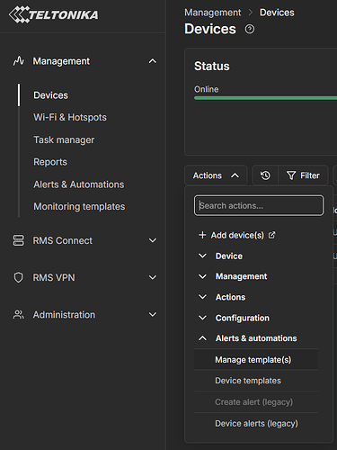

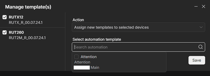

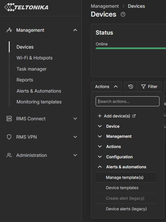

Hello @amadgwick,
At the moment, there is a method available for adding the same Alerts & Automations template to multiple devices at the same time.
On the RMS page, navigate to Management → Devices and select the devices to which you would like to assign the automation. Then, open the Actions drop-down menu and navigate to Alerts & Automations → Manage template(s).
A new window will appear where you can verify the selected devices and assign the desired automation template to them.
