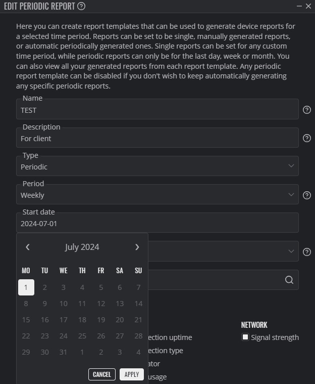

Yes, there is an option to create periodic reports based on a particular date, to achieve this you need to select “Start date” when creating/editing a periodic report. However, this function only allows you to select the start date on a weekly/monthly period, despite the fact that you are not able to select the time. You can find more information on our wiki page.
Also, I assign a screenshot where changes should be made to achieve this configuration.

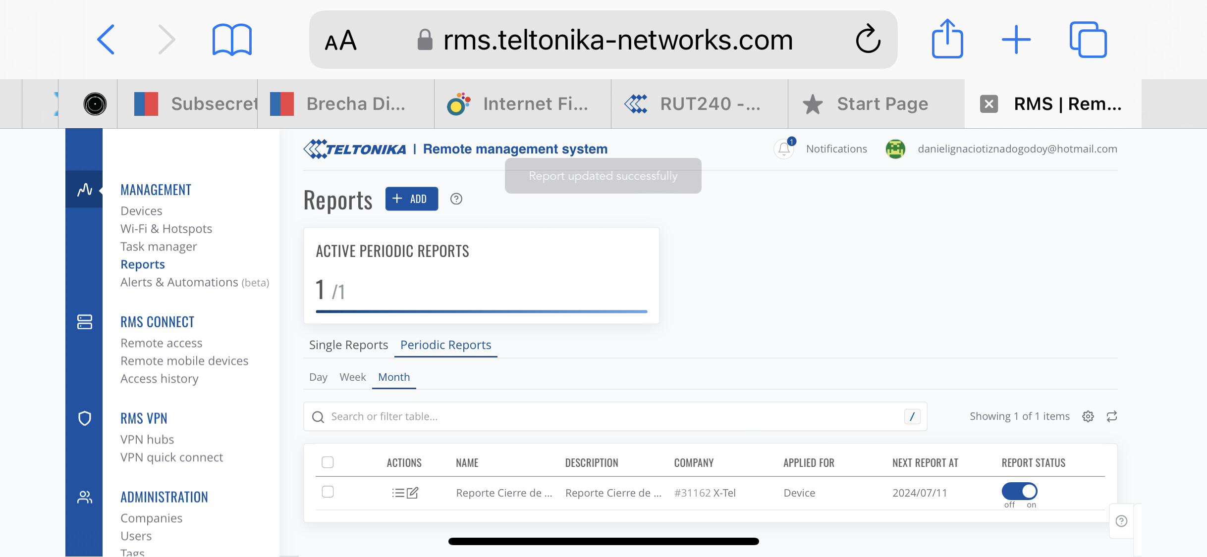

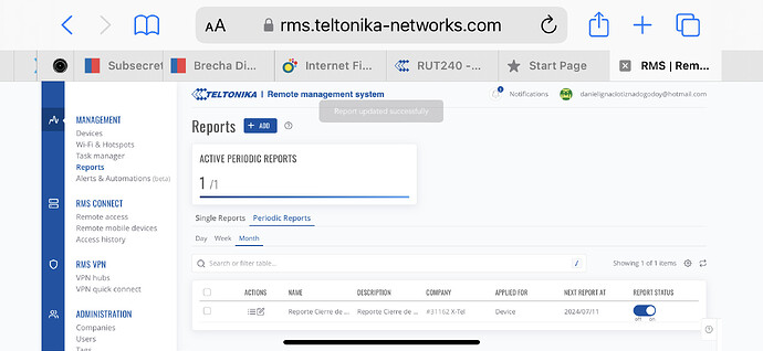

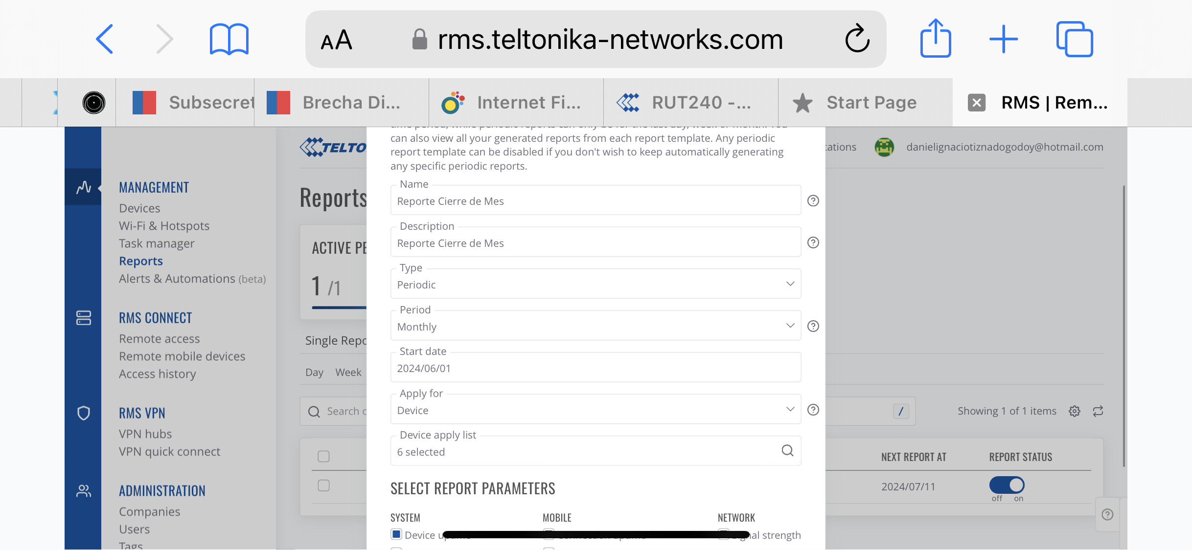

Hi, thanks for your kind reply. I have tried what you said to me but still finishes or creates the report on an unselected date which usually is the 10th to 11th. I will attach some pictures to show you. I need the report be finished” or ready on the last day of the month where on the 1st I can look at it.
Hopefully I make sense
