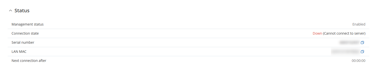

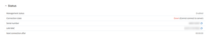

  1. Have you tried either:
  • Pressing the Connect button from the RMS WebUI on the device itself (Services → Cloud Solutions → RMS),
Yes, but makes no difference. It starts by connecting, but then reverts to error messages below.
[image][image]

Could you please confirm whether these new devices have an active internet connection when you attempt to add them to RMS? Additionally, would it be possible for you to provide the connection logs and statuses visible on the RMS Device details page as well as from the WebUI (Services → Cloud Solutions) RMS page at the time the device was added but failed to connect? As already mentioned, I wasn’t able to view the images you previously shared.

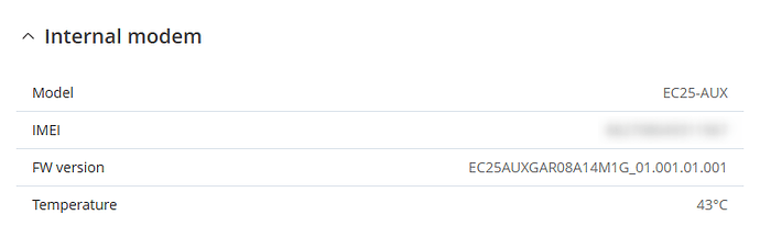

Lastly, if possible, please provide the modem model (as seen in Status → System page) of the devices you’re having trouble adding to RMS.
Hi Martynas,
Also, forgot to mention that i have connected approx 10 RUT units to RMS with very little issue.
Yes, all attempts have been with working active internet connections.
All details were checked and double checked, as previously mentioned I had done this a number of times with no issues.
Modem details
Kind regards
Neil Loveridge
