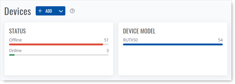

There shows no reconnection attempts and we are still having 130 devices offline.
What is the next step?

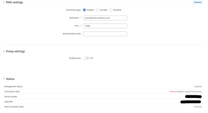

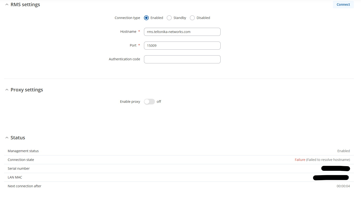

i have force the connection 10 times over the last hour with various reason for failure.
“Failure (Failed to resolve hostname)” is the most recent
I have re registered the device 5 times int he last 2 days.
SN and MAc address are perfectly matched.
Please check if device has internet access and is able to resolve DNS. Execute these commands in CLI:
