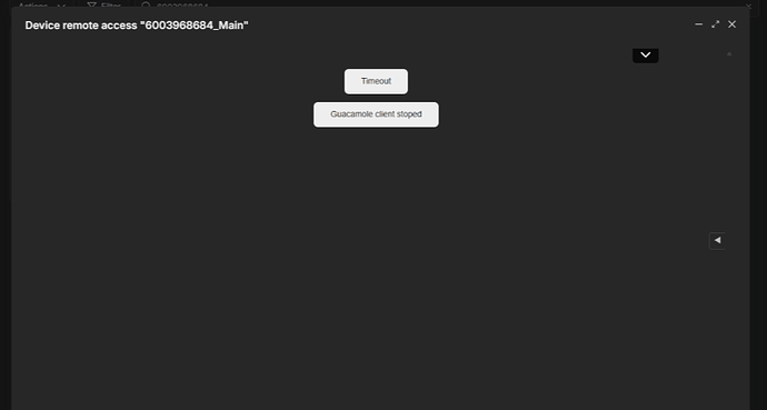

I am having a problem connecting to routers with the VNC protocol. In all cases, the error “Timeout” appears followed by “Guacamole client stopped.” I do not have access configured with username and password, but it has worked this way for all the accesses I have had for some time. Could there be a particular error today?

Hello @Tomas.SantaCruz,
Could you please check whether the issue with the VNC connection persists? There have recently been some changes made related to this error.
If the issue continues, please let us know so we can investigate further.
Now is working!
Thank you
