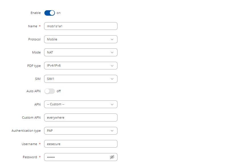

Could you try setting the PDP type to IPv4/IPv6 and share a screenshot of the mob1s1a1 interface in the Network → WAN page?
The issue is that RMS currently only supports IPv4, so if the device only supports IPv6, it will not be able to connect. However, it is very unusual for European carriers to only provide IPv6 addresses, so it could be that you’re receiving a dual stack connection (both IPv4 and IPv6 addresses). In this case everything should work fine.
Make sure you’re using the standard EE APN:
APN: everywhere
Authentication: PAP
Username: eesecure
Password: secure
And check if the behavior is the same.

Since the pings to IPv4 address fails, it’s likely that even in IPv4/IPv6 mode your device is only receiving the IPv6 address. This can be checked by navigating to Network → WAN and checking the mob1s1a1 (SIM1) or mob1s2a1 (SIM2) interface. In a real dual stack configuration, you should see three IP addresses when hovering over the informational symbol:
If you only see IPv6 address, then I’d suggest contacting your carrier and requesting an IPv4 address alongside the IPv6 addresses. It does not have to be a public address!
