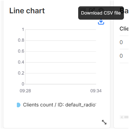

You can export data from RMS by pressing the export CSV button, see screenshot :
I would recommend checking the available options, to see if any of them would suit your needs, the available options can be found in the dashboards tab, the one you are already exploring.
