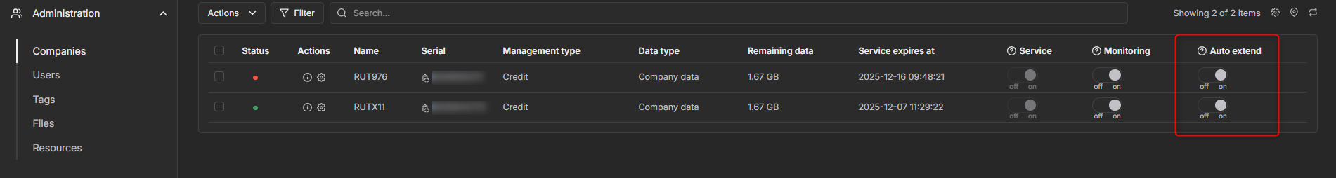

Regarding your question - there are no additional fees when using RMS beyond the required credits. If Autoextend is enabled, the device will automatically use credits from your RMS company account and re-establish its connection. The reconnection interval can vary, typically anywhere from a few minutes up to several hours.
To enable Autoextend, navigate to:
Administration β Companies
Select your company β Enable the toggle under Autoextend.
