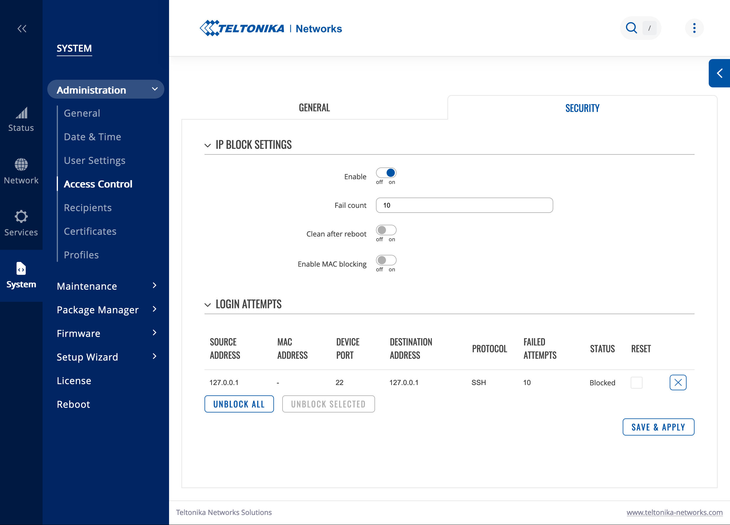

However, it didn’t work immediately. I was still getting the same Error: Error reading SSH protocol banner as before even when I tried with root. I then discovered that my failed attempts to connect as admin had resulted in the router blocking all logins from 127.0.0.1. So I first had to remove the block rule using the router’s WebUI page: System | Administration | Access Control | Security | Login Attempts (see screenshot below)
After that, it worked. Thanks again!
