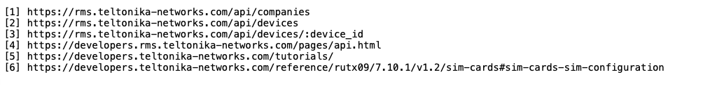

Here are the missing links (Part 1 - as I can’t event put more than 2 links in a reply…):
[1] https://rms.teltonika-networks.com/api/companies
[2] https://rms.teltonika-networks.com/api/devices
here’s part 2:
[3] rms . teltonika-networks . com /api/devices/123
[4] developers . rms . teltonika-networks . com /pages/api.html
Part 3:
[5] https:// developers . teltonika-networks . com/tutorials/
[6] https:// developers . teltonika-networks . com/reference/rutx09/7.10.1/v1.2/sim-cards#sim-cards-sim-configuration

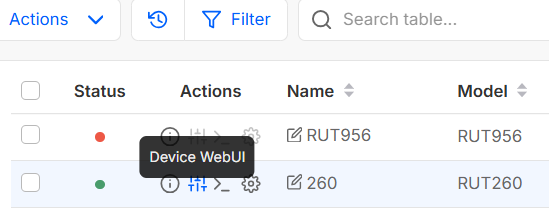

After that, generate an RMS WEBUI link (see screenshot and link to video)

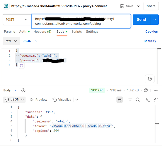

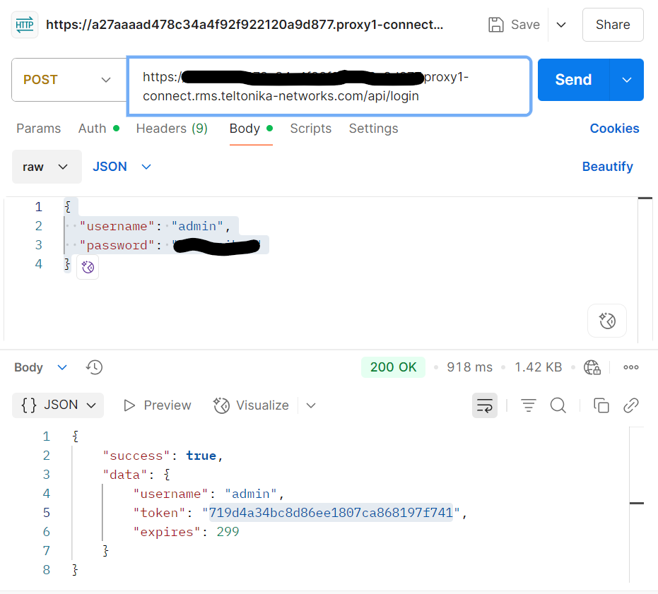

And paste that link in Postman as a POST command, with endpoint /api/login at the end. https://developers.teltonika-networks.com/reference/rut260/7.14.3/v1.6.3/authentication#post-login . As Authorisation type choose bearer token, and then post the token you received in RMS API. in BODY paste this text :
“username”: “String”,
“password”: “String”
While changing the values to the ones you use to login to router’s WEBUI.
In the values you receive, you will receive another token. Please save that token in your notes, as it will be needed in further steps. (See screenshot example)
Getting this device access token allows you to utilize the rest of the API capabilities.

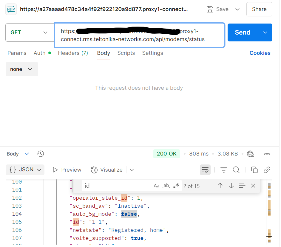

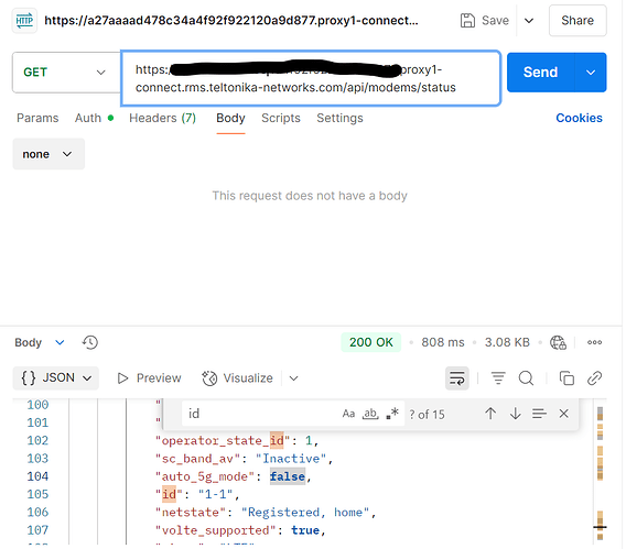

In your case, as you need to change the Pin code of Sim card, you will firstly need to find out the modem ID. To do so, you need to open up another Postman instance, now choose GET, and then paste the RMS WEBUI link, along with endpoint /api/modems/status. https://developers.teltonika-networks.com/reference/rut260/7.14.3/v1.6.3/modems#get-modems-status .
Go to auth, choose bearer token, and paste the token that you received in the previous request. Not the one received in RMS API. Then press send. (see screenshot of example)
In the received values, you need the “id” value (For example 1-1). Save that value, as you will need it in the next step.

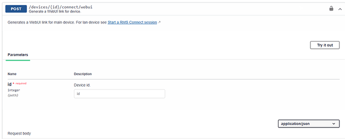

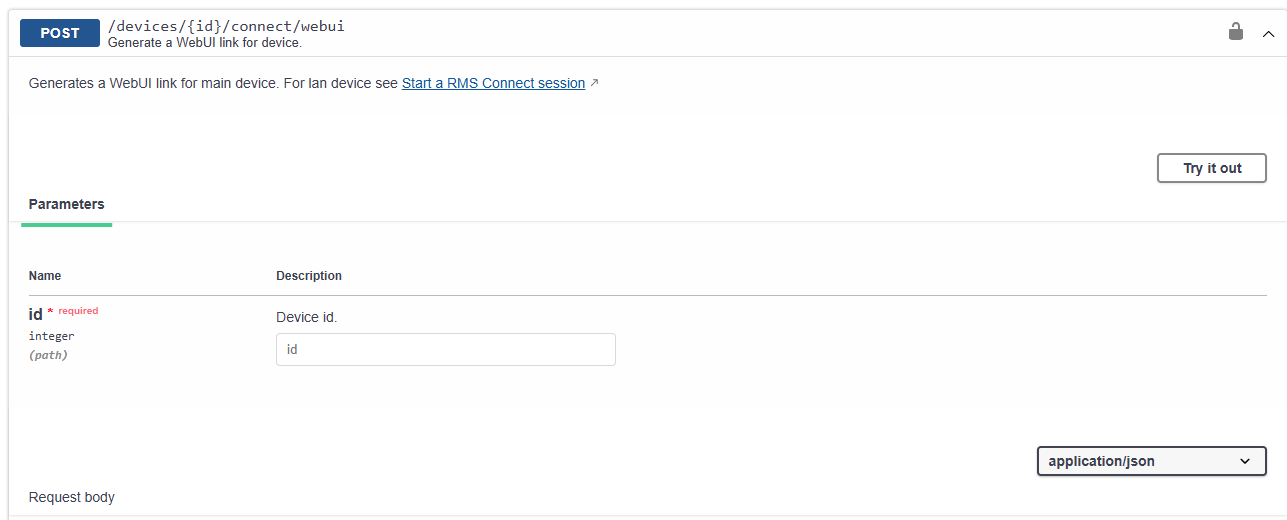

I’m missing the part where I would get the device URL. Right now, the guide asks me to login to RMS and then click a link and copy the URL. Is there a REST request to generate the URL?
Please see the endpoint for generating a remote connection for API
I would also recommend having a read on our API functionality, to understand and use it more efficiently.
