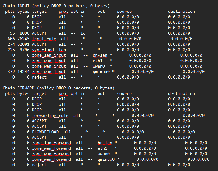

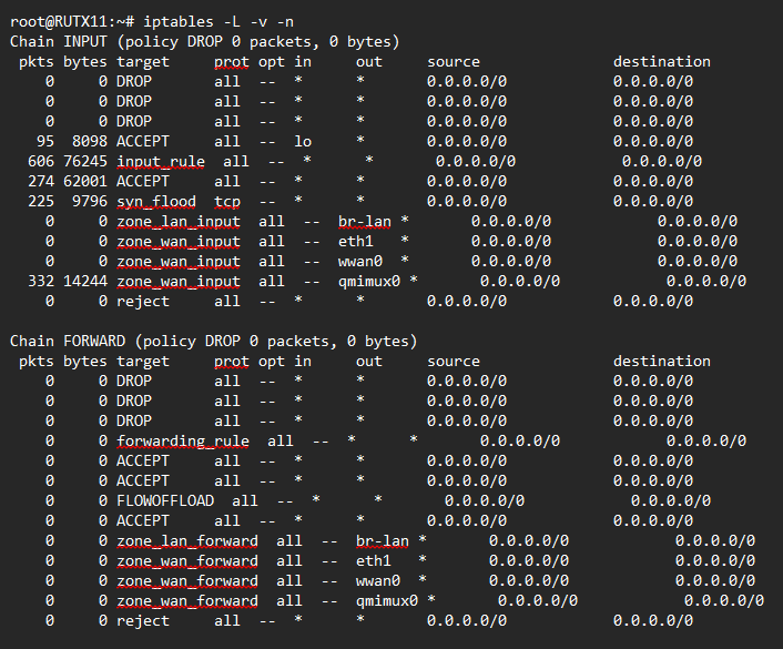

After testing this out, I came to a conclusion that writing these commands will not make much of a difference. Here’s my results (I used the command iptables -L -v -n)
Nothing changed:
Changed & restarted firewall service:
I suggest just using /etc/init.d/firewall stop and /etc/init.d/firewall start as you can manipulate these easily without needing to reboot the device.
