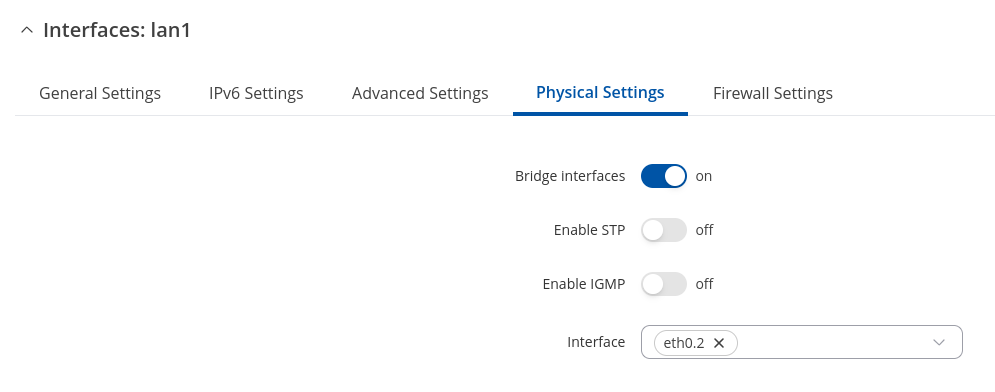

But I have an existing network using VLAN ID2 where the RUTXR1 is now planned to be the main router. Do I really need to reconfigure all switches and devices because of this?

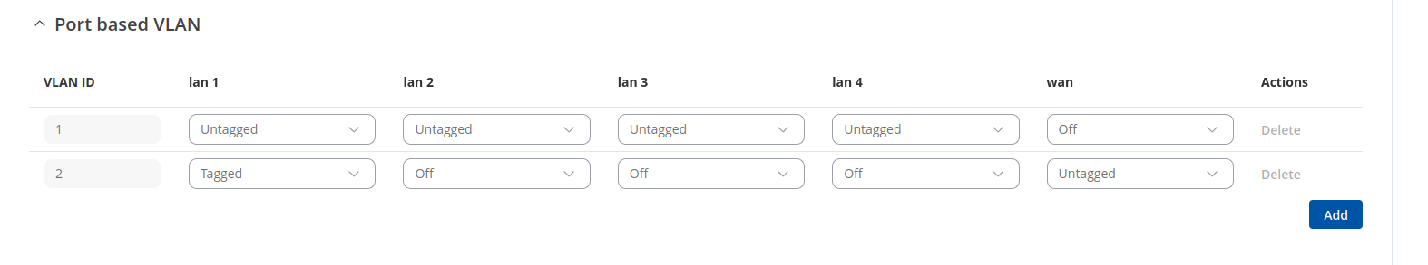

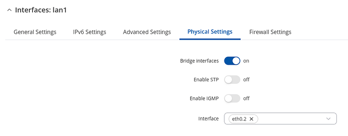

you can use VLAN2, just manually enter eth0.2 into physical settings like this:
This should work.

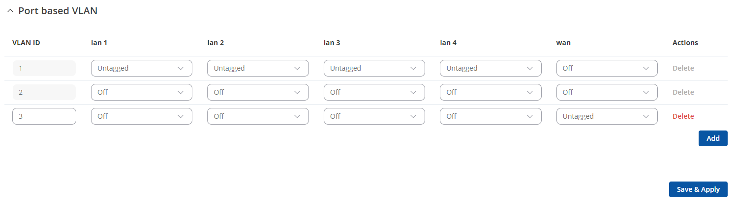

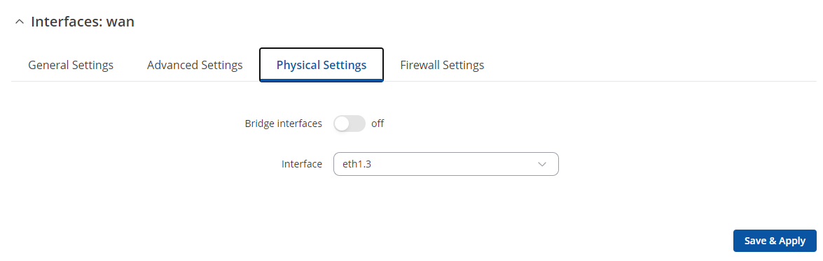

If you are planning on using VLAN2 for a different port apart from the WAN port, then you first have to re-assign a new VLAN for WAN port (i.e. VLAN3). It should look similar to this.
Let me know if this helps.
