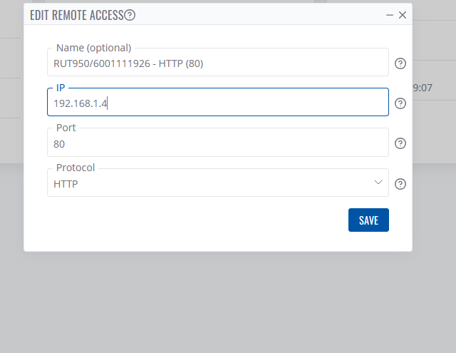

Hello, I have a small problem and I hope you can help me out. We have set up an RUT980 router with a 4G SIM card that is remotely controlled. To access it, we’ve configured RMS Connect and added the IP address (192.168.1.4), which works great. However, the issue is that the page we need to access is at 192.168.1.4/start, but we don’t have a adress interface. Do you have any tips to resolve this ?
Of how we can make a forward.

Thank you for taking the time to reply. Just to clarify, the connection to the device is working, and we can access the HTTP interface. However, the issue is that the specific page we need to access is located in a subfolder (e.g., 192.168.1.4/start), and we’re unable to redirect to it.
Do you have any suggestions to resolve this?
