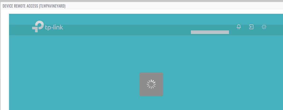

The first point (manually or auto-scan) I don’t understand. I just add the AP from the port list, fill out the specifics and add it to the remote list. When using it I get almost the login screen. So TP-Link logo appears but before the login starts I get an everlasting windmill.
So it appears that I am almost there… close but no cigar.

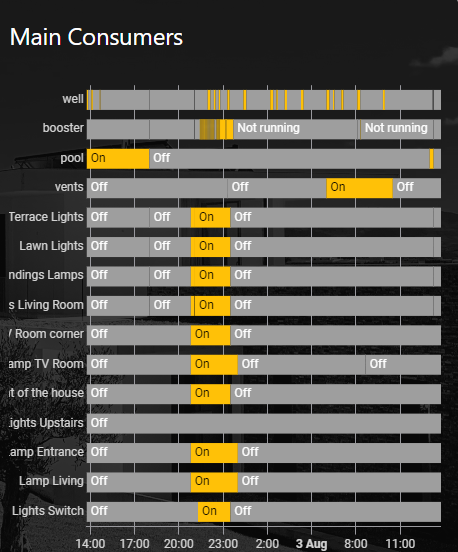

Yes the RMS is working and I have no issues with connecting to the router either via http or ssh. I have a remote connection to a raspberry P4 and also smooth. I am trying to get a connection with the TP-links for changing parameters and evt reboot. I got some very poor lan performance. However and fair is fair after the initial problems loading the latest firmware the LAN performance is almost picture perfect. No clue if it is related but it looks much better.
Solid grey or yellow is a good connection. The black lines or black parts are loss of connection:
Before:
After:
