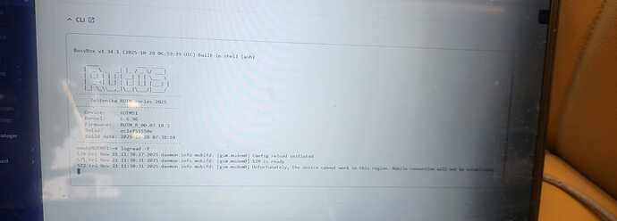

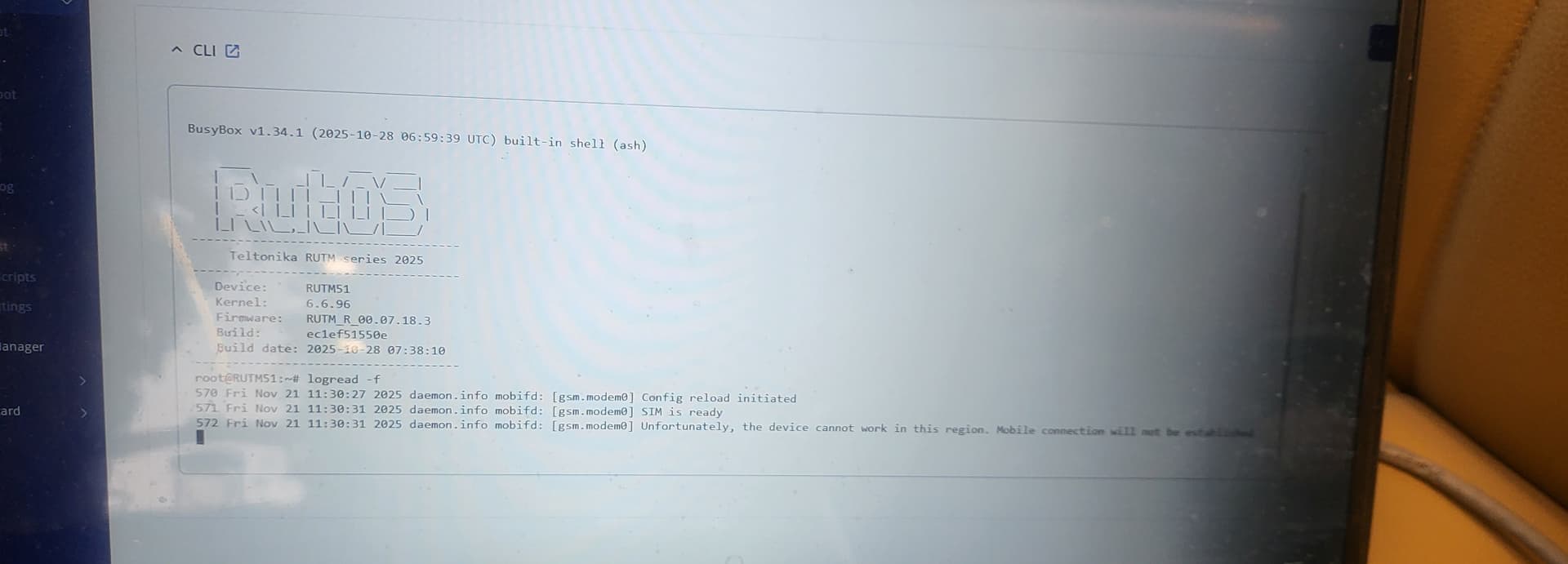

i am getting this error I am using rtum51. Brand new device .. I cannot connect to any mobile networks in india. What to do?

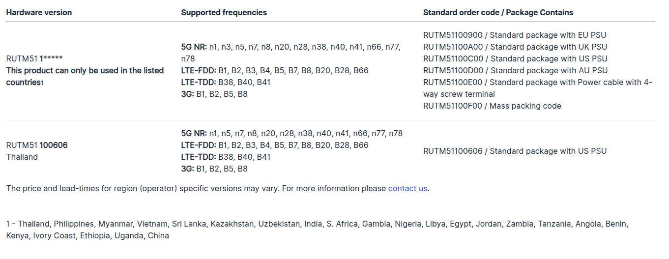

Double check hardware version, if it’s 100606 return item if possible.

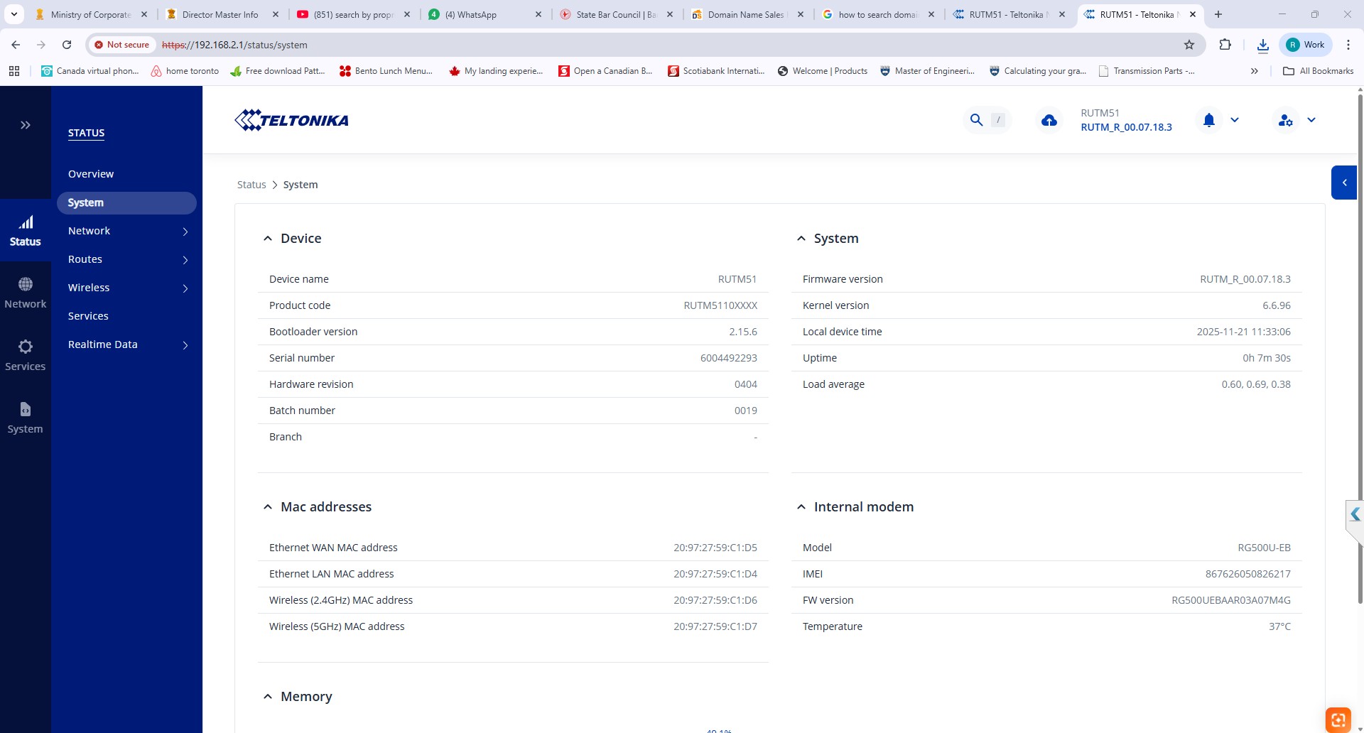

I have this to be used in india . Getting this error
Hello lemondude. Can you give me a link or hint where you found these details, please? Does it mean the router is not allowed to be used in Europe for example? I can’t find this information on the product page of the Teltonika homepage.
I found it in the ordering section of the product page. Is it really correct the router is only available/allowed in these few countries?
