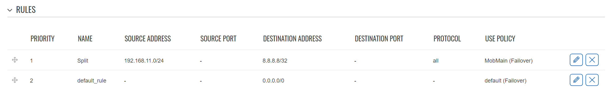

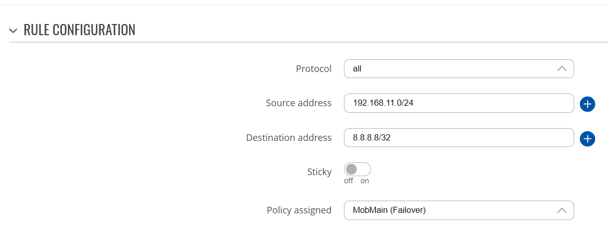

For this, you can use the failover functionality (mwan3 package).
Navigate to Network → Failover and create a new rule at the bottom. There, add a new failover policy at the bottom and select the interface that you would like to use. At the top of the page, specify protocol, source and destination IP addesses and apply the newly created rule. Save & apply.
On the failover page, drag the new rule to the top of the list.
Now, whenever the protocol, source and destination IP addresses match, the new rule will apply and it will route the packet via the specified interface.
Here’s an example to route 8.8.8.8 via mobile interface:
