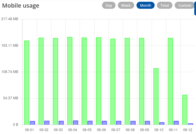

Hi all,
When selecting “Day” period it shows “No mobile usage data collected” but this is impossible because I read it remotely. When selecting a longer period the current day is zero, yesterday (when I done the upgrade) seems coherent at last until upgrade.

Today the “No mobile usage data collected” appears in all tabs (day, week … and custom).

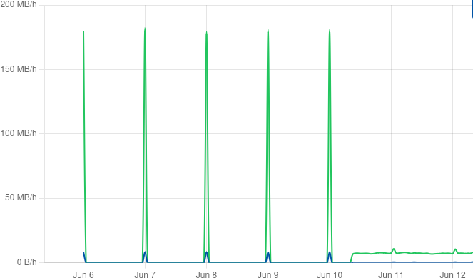

Note : I also notice a bug concerning older firmwares in “Realtime Data” > “Traffic” when selecting “week” option. When looking at >48h old data all the usage seems to concentrated at 23h. This alters values for the “2 days ago” bar in “Realtime Data” > “Traffic” and “Realtime Data” > “Mobile Usage”.
“Realtime Data” > “Traffic” on a in use modem with 7.14.2 firmware :
For my application the mobile usage is almost constant with just a little transfer at night (the right 48h part in traffic graph is ok).
