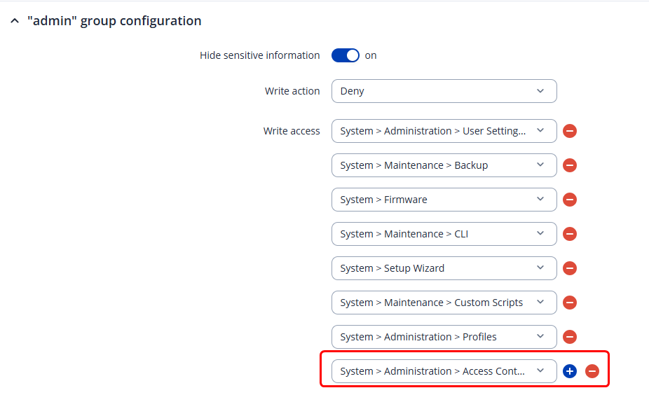

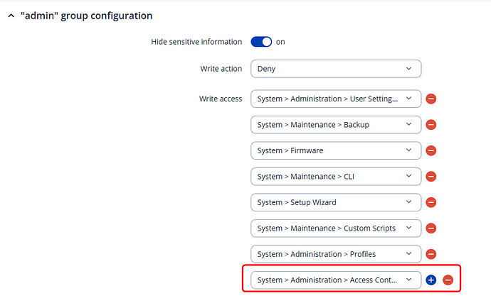

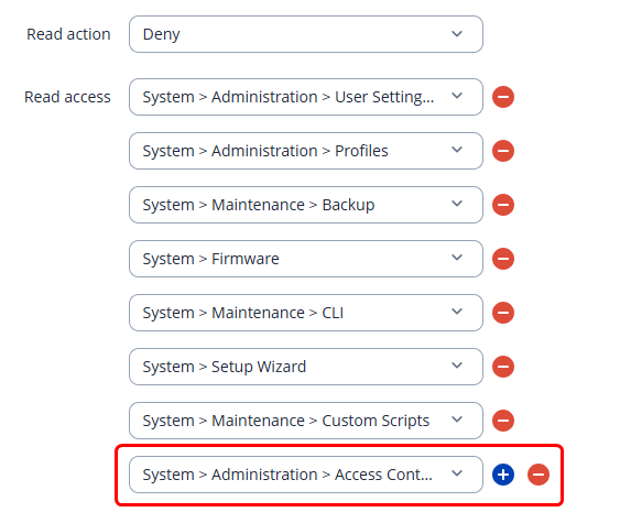

For this, simply log in to your default “admin” account, head to the user group settings, and edit the “admin” user group, and make sure to remove both of the “Access Control” flags from the Read and Write lists:
Thank you very much. It would be great if non-root users would be able to log in, or if it would be possible to independently set the root password for ssh logins (or even use ssh keys to log in).
