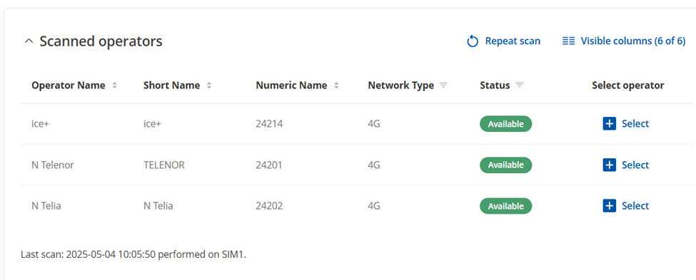

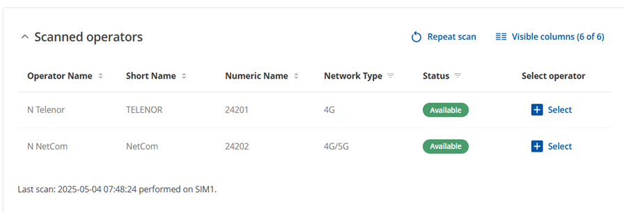

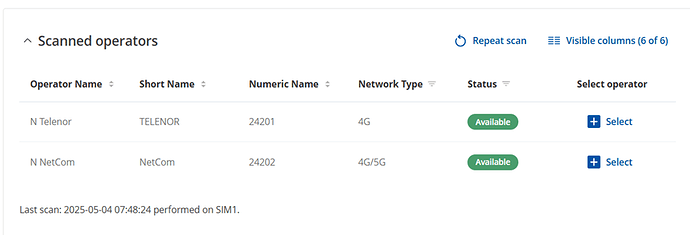

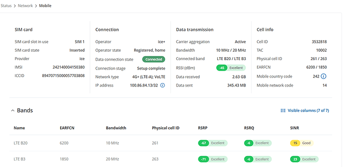

RUTM51 with latest version of firmware and modem firmware only finds 2 providers and not my provider when scanning for providers. The SIM-card works perfectly in a RUTX11 with all 3 available providers are found. RSRP and RSRQ are Excellent and SINR is Good. When setting APN and code for my provider manually I get Data connection state “Connected”, but no data transfer and Internet is not working. See pictures. Antenna is the same for RUTM51 and RUTX11. The result is the same if I use 4G only or 3G/4G/5G.
Any idea what this can be? Is there a specific difference between the modems in the two routers or is it a software problem?

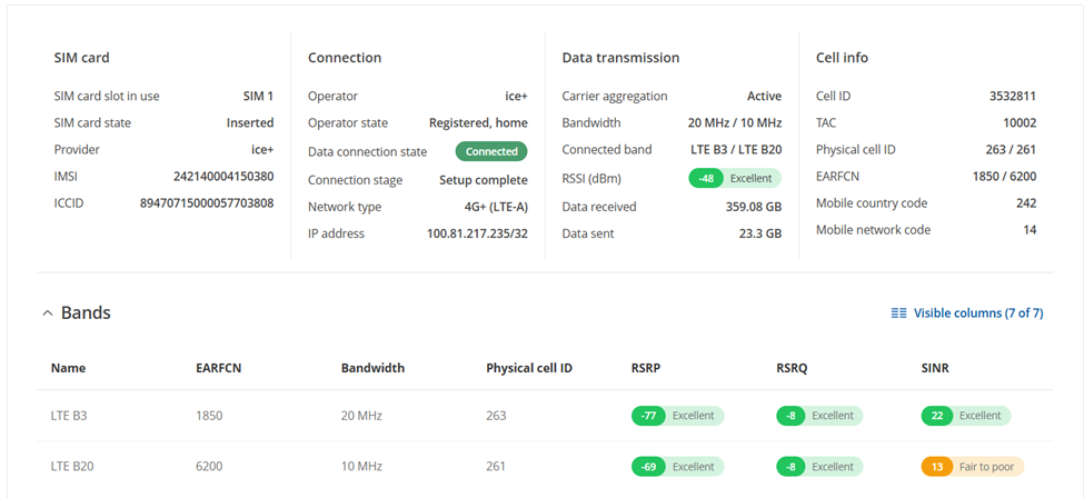

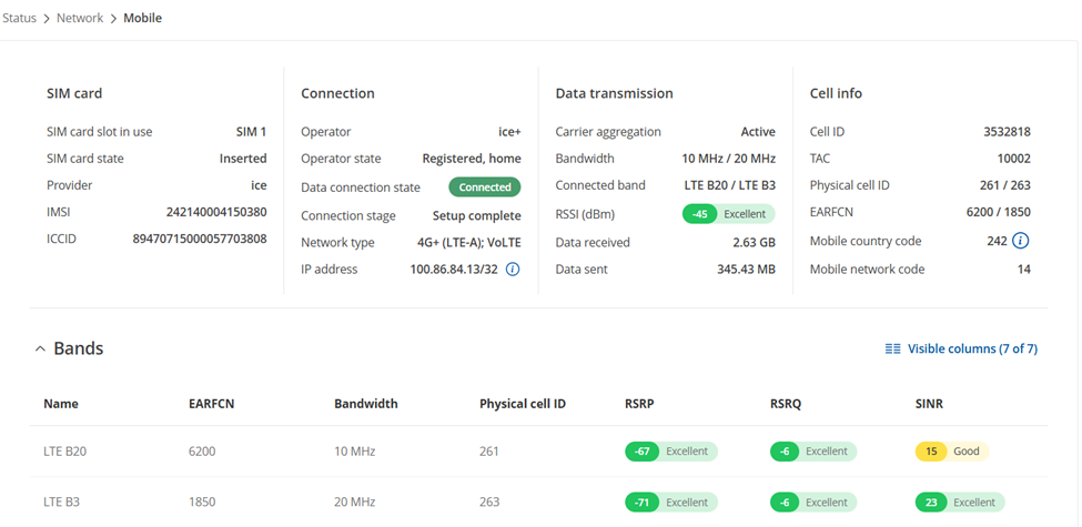

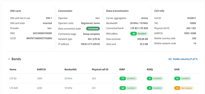

Check if RUTX11 and RUTM51 connects to your provider and uses same LTE bands. Because it could be that RUTM51 doesn’t support band which your provider use and RUTX11 supports.
Thank you for your suggestion, but both routers use B3 and B20.
RUTX11 information

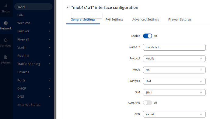

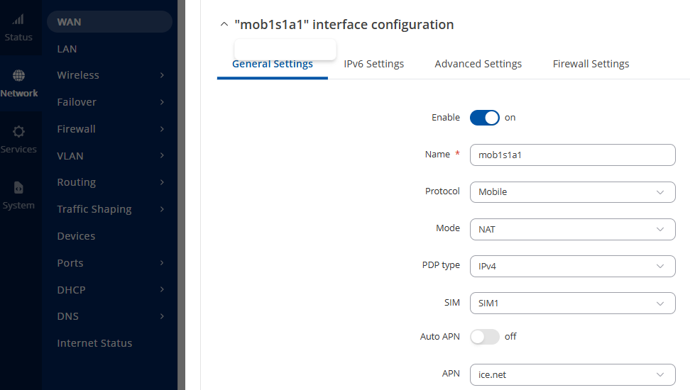

In case someone else gets the same problem.
I found a method to make it work, but if it’s a workaround or a solution could be discussed I think. What I did was editing WAN settings for mob1s1a1. In General settings I changed PDP to IPv4 (turning off Ipv6) and restarted the router. Then it connected, and scan also finds the provider.
