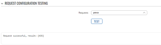

If i try to read the slave directly from the TRB255 with the configuration test function, it works.
Also if i setup a data sender, i can get the parametrs i want.

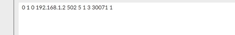

The problem happens when i try to reach the slave from a mqtt client.
In this case the response is the read register error.

String sent via mqtt client:
Could you also upload a screenshot of the prova request?
Here it is:
