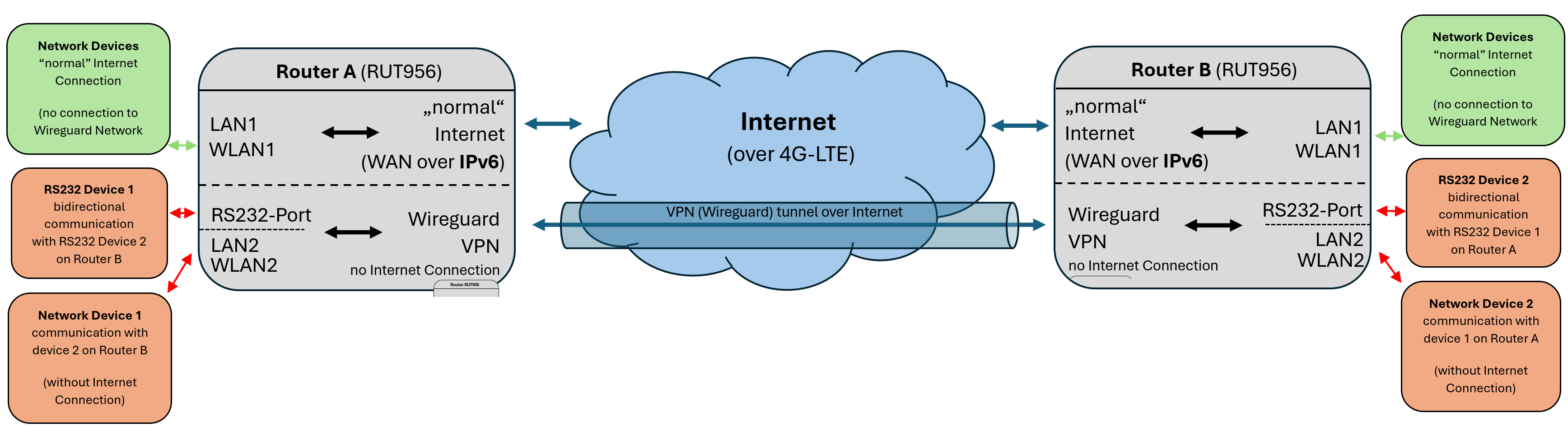

Unfortunately, I have come up against several hurdles in the configuration of two RUT956 routers. After many hours of configuration attempts and corresponding research, I would be very grateful for support, as there are obviously some important points that are unclear to me.
For a quicker explanation of the configuration I want, I have attached a corresponding diagram as an image.
If the configuration I am looking for with the RUT956 routers (and its configuration options) is possible at all in this form (I would be very happy to receive answers on this alone), I would first have the following questions:
  • since no public IPv4 addresses are assigned in the 4G network in Germany (4G routers cannot be reached from outside via IPv4), I would like to use IPv6 (corresponding option with fixed IPv6 address is activated/booked in the LTE contract (Deutsche Telekom)). Here I need help for the correct, corresponding configuration of the routers
  • Can the RUT956 route its RS232 connection between two routers through a Wireguard VPN tunnel? What is the correct configuration here (the general Wireguard configuration is known)?
Unfortunately, my first hurdle here is a direct connection between the two routers via IPv6, which does not work. My lack of IPv6 knowledge is probably the main problem here.
I really hope for your help. Many thanks in advance!
