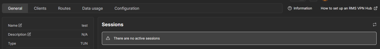

  1. First, when the VPN connection is active, i.e., you’re connected to the VPN by using some client (OpenVPN Connect, Teltonika VPN Hub client, etc.) - does your RMS user and your device that you have added appear in the list under RMS VPN → VPN Hubs → Clicking your VPN Hub → General tab? You should see your clients here:

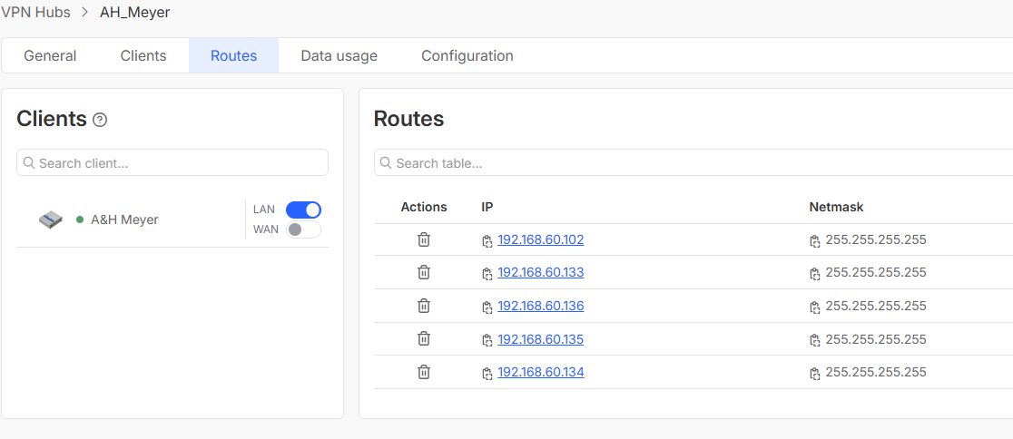

  2. Secondly, what routes do you have set up, in the same VPN Hub routes tab?

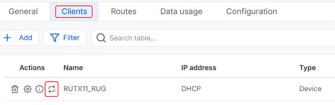

  3. Please also try to re-push the VPN configuration onto your device. Head to the Clients tab in the VPN Hub settings, and press on this little button:

  1. When the OpenVPN connection is active, only the RMS user appears under Sessions in the VPN Hub. The device/router is not connected.
  2. See screenshot.
  3. Done, nothing happened.

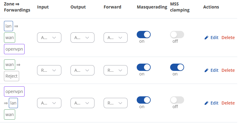

  4. Under the specified path, I only find a list of zones. Which one is meant, and how do I enable it? (See screenshot)
I believe something needs to be configured in the customer’s network firewall. UDP ports should actually be open. Or is there anything else I could configure to get the TLS handshake working?
In regard to point No. 4, you seem to be in the incorrect window; you wanna look under Network → Firewall → Zones, you seem to be under Status → Network → Firewall. There’s a separate Network tab on the far left-hand side.

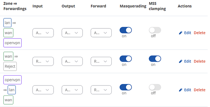

I’ve now enabled masquerading under LAN → WAN; it was turned off before.
Is that what you meant? See screenshot. Unfortunately, it didn’t help.
Correct, after enabling the setting, could you confirm that it is still not functioning properly?
