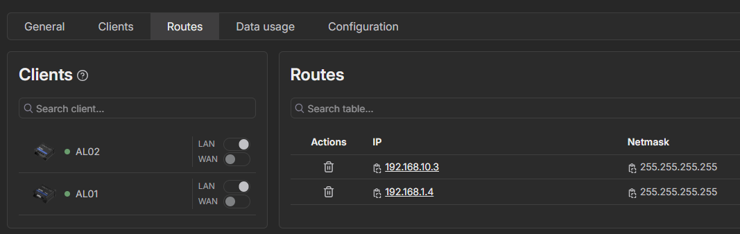

- If you don’t mind, could you try changing the routes on your device to be 192.168.10.0 255.255.255.0 (or 192.168.1.0 255.255.255.0, depending which device routes don’t work) instead of having a direct route? Make sure to delete the old routes and give the hub a restart after the changes.

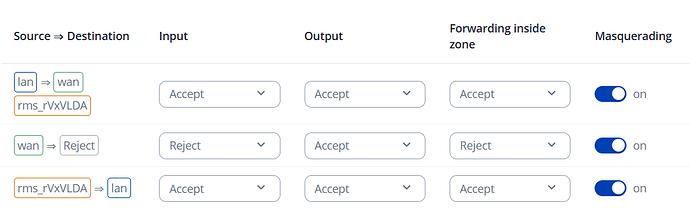

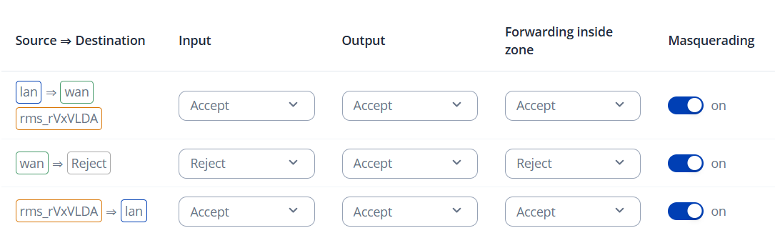

- Additionally, head to Network → Firewall → Zones and enable Masquerading on the LAN=>WAN zone and give it a Save & Apply.

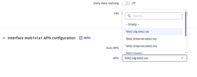

Hi. The problem is solved. It was an issue with mobile coverage. I assume it’s because all operators in Sweden closed 2G/3G two weeks ago, and 4G doesn’t work so well at high altitudes. I changed the preferred network type to 4G only. I also changed the APN to 4g.tele2.se; otherwise, when it was set to AUTO, it used internet.tele2.no.The connection is still unstable, but that’s another problem.
