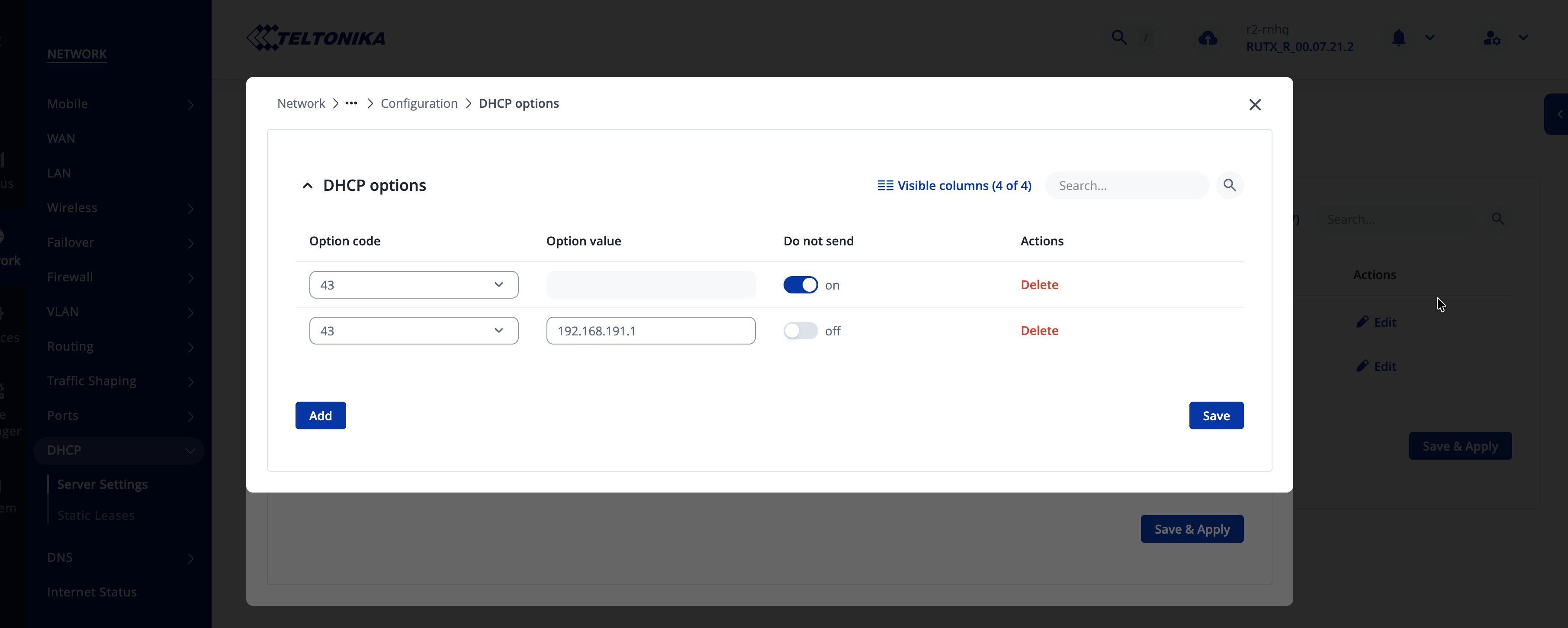

I rebooted my RUTX11 today that was running 7.21.2
After rebooting, I noticed that the DHCP advanced page had some strange configuration
And the raw /etc/config/dhcp looked like this (duplicate option 43)

Seems there may still be a bug around this?
After updating the 7.21.3 and rebooting, the phantom option 43 seemed to disappear. Will keep posted.
