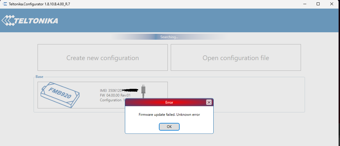

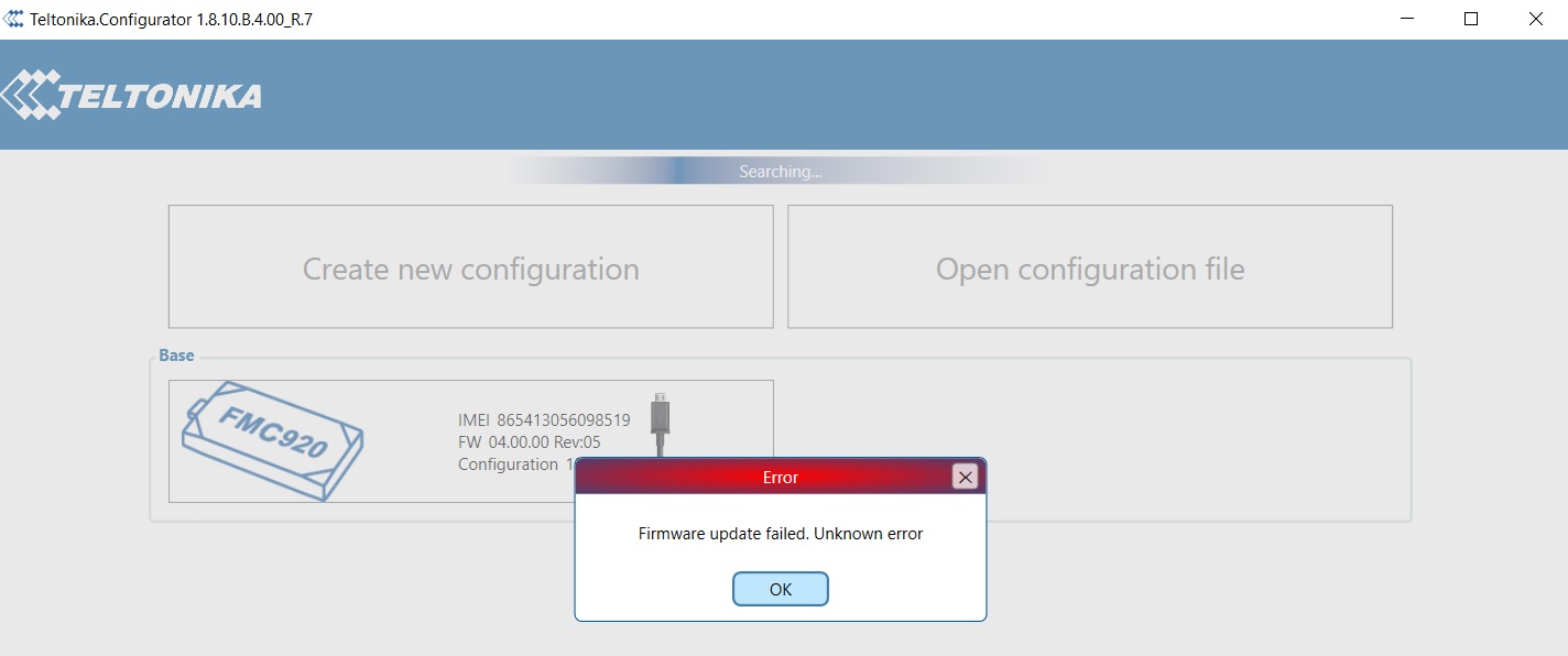

I’ve already contacted my provider but haven’t received a response yet. I tried updating to version FMB.Ver.04.00.00.Rev.09_ID1.e but I get the following error:
Do you think you have another firmware version to try? Is there any way to go back to a previous firmware version?

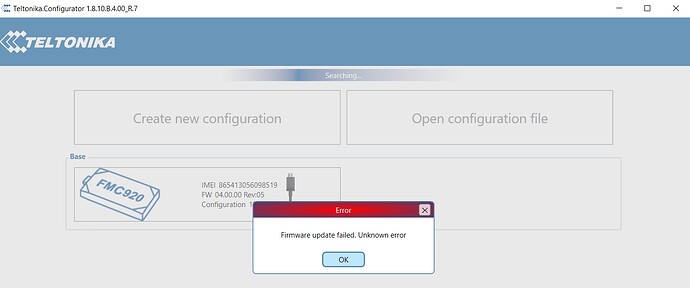

I raised the same issue in a separate topic and after almost a month I still haven’t received a solution. The provider has not yet provided a solution to this problem.
I tried to test with the version you provided here, but unfortunately I got the exact same error.

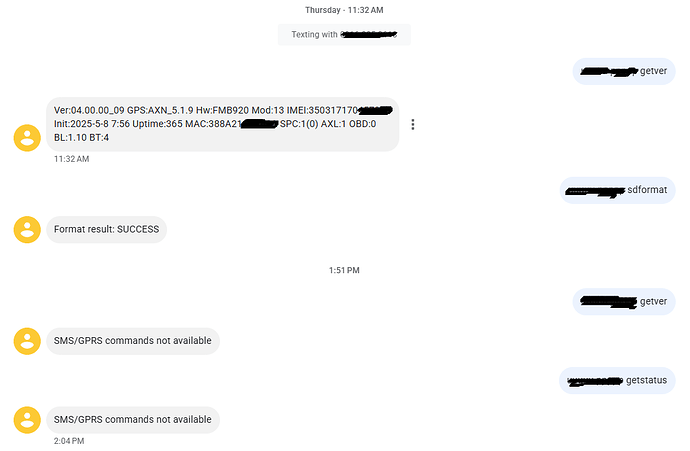

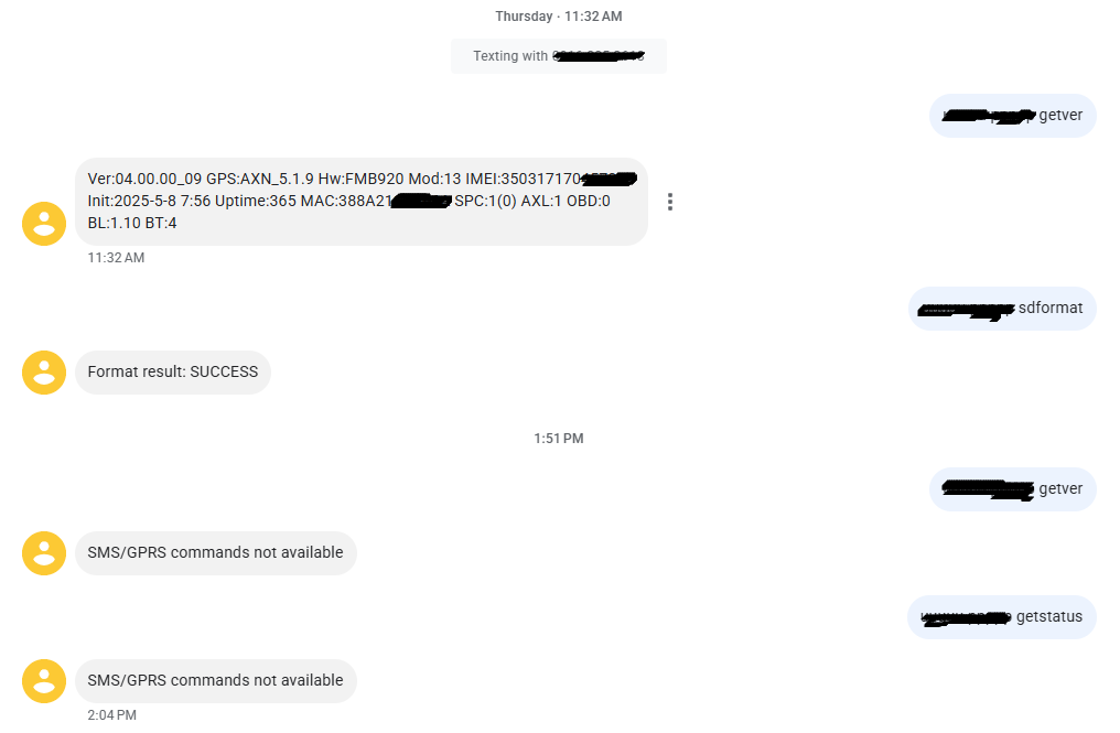

Dear @Maynard
It’s not working !!!
After update FMB920 (It hadn’t stopped yet and was working properly) with Ver.04.00.00.Rev.01 to 04.00.00.Rev.09_ID1.e, I checked and there was no problem, the connection was established and it was sending information to the server. I even checked with SMS commands and everything was correct.
Today I noticed that the test device lost connection to the server and when I checked again, I noticed that the same thing happened again.
This happened again in less than a day and I feel like it’s not just me and others will have this horrible experience. It is really expected that Teltonika will provide a clear answer to this problem, especially after this problem was created by Teltonika, which immediately removed the version in question completely from the site!
