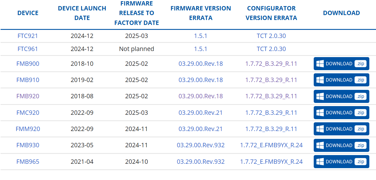

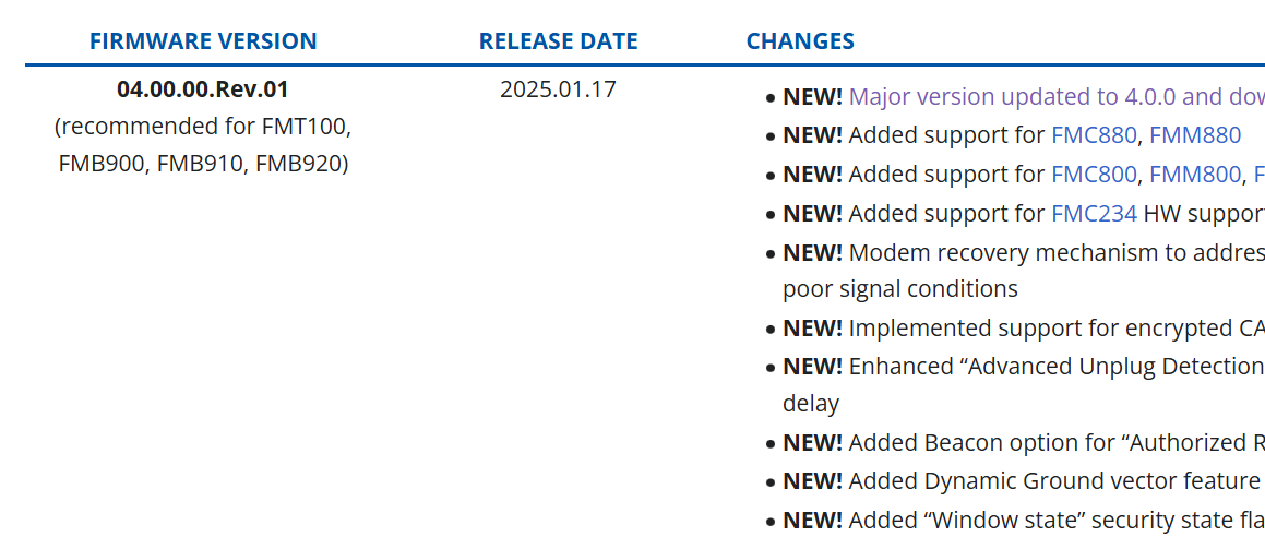

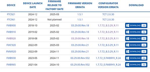

Thank you for your response.
But I have an important question: Why was page “Firmware versions” of the updated information placed back in the section related to the old version 03.29.00.Rev.18?
The next issue is why is there still version 04.00.00.Rev.01 on the dedicated page FMB920?
