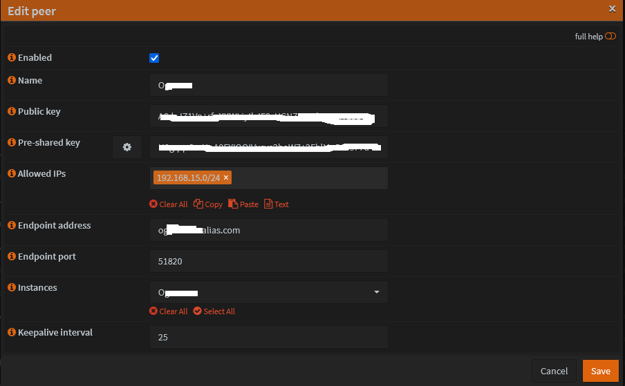

OPNSense - 172.12.219.12

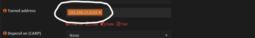

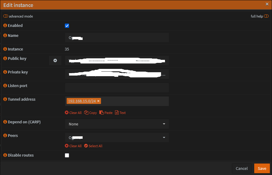

Instance - Network01:
Tunnel address: 192.168.15.0/24
Peer - Network01:
Allowed IPS: 192.168.15.0/24
Endpoint Address: dyndns…..
Port: 51820

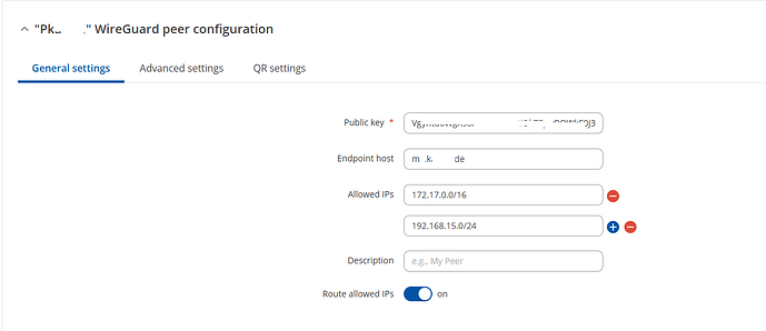

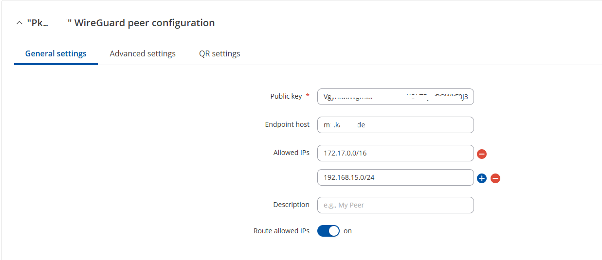

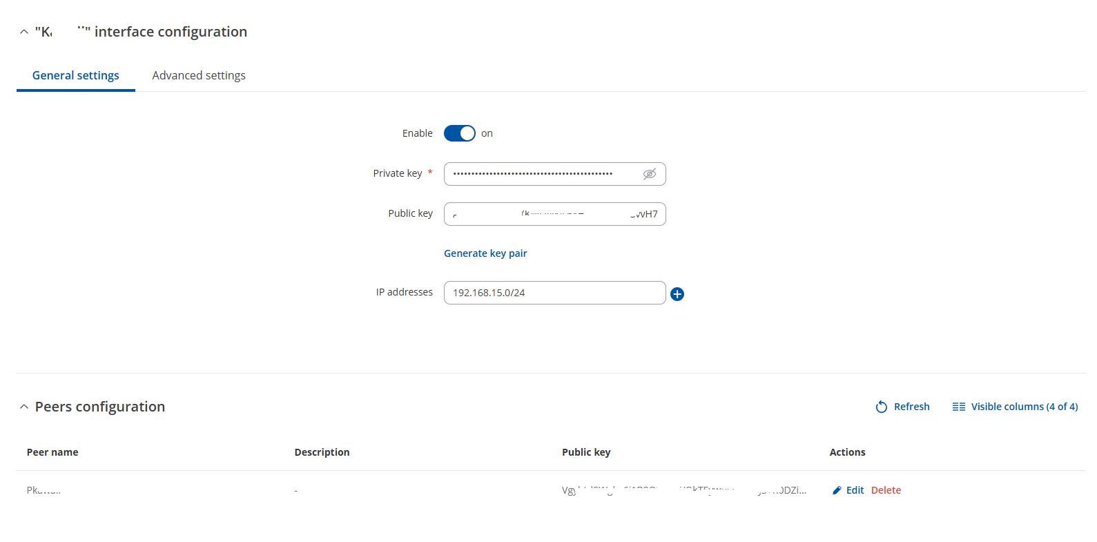

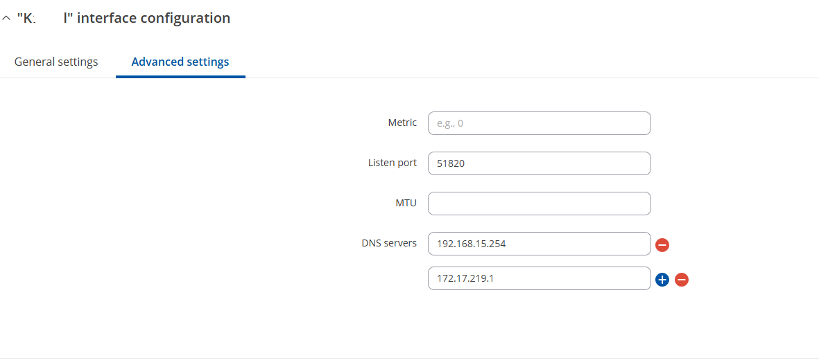

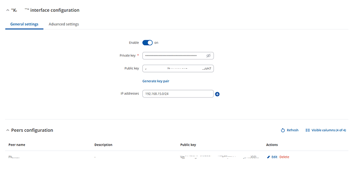

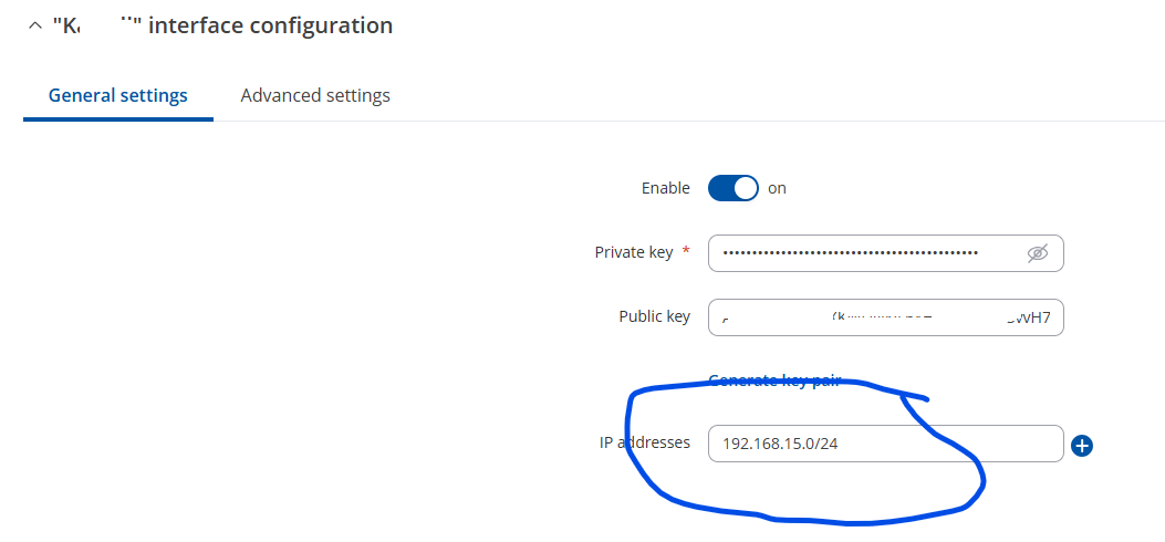

TELTONIKA RUT240 - 192.168.15.254
Instance - Company
IP Addresses: 192.168.15.0/24

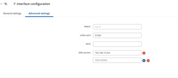

DNS servers: 192.168.15.254, 172.17.219.1

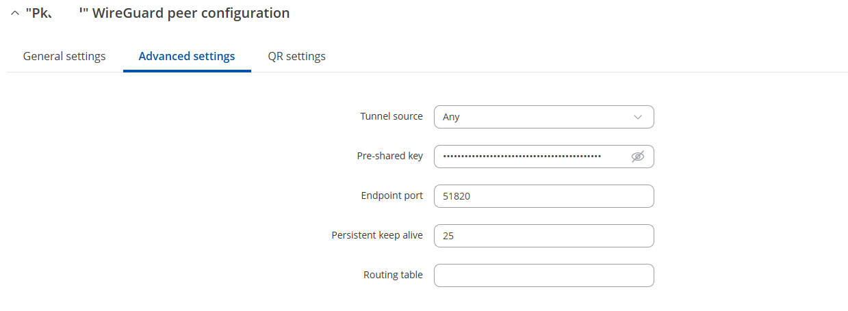

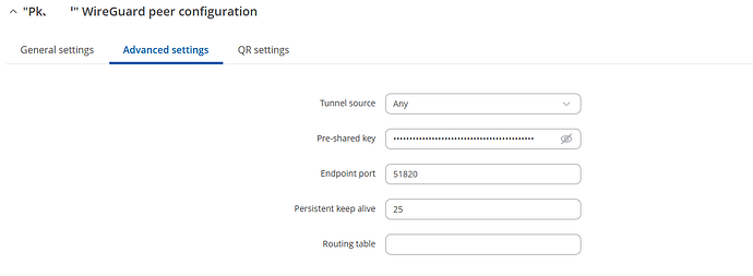

Peer Company:
Endpoint: dns name public
Allowed IPs: 172.17.0.0/16, 192.168.15.0/24
Endpoint port: 51820
