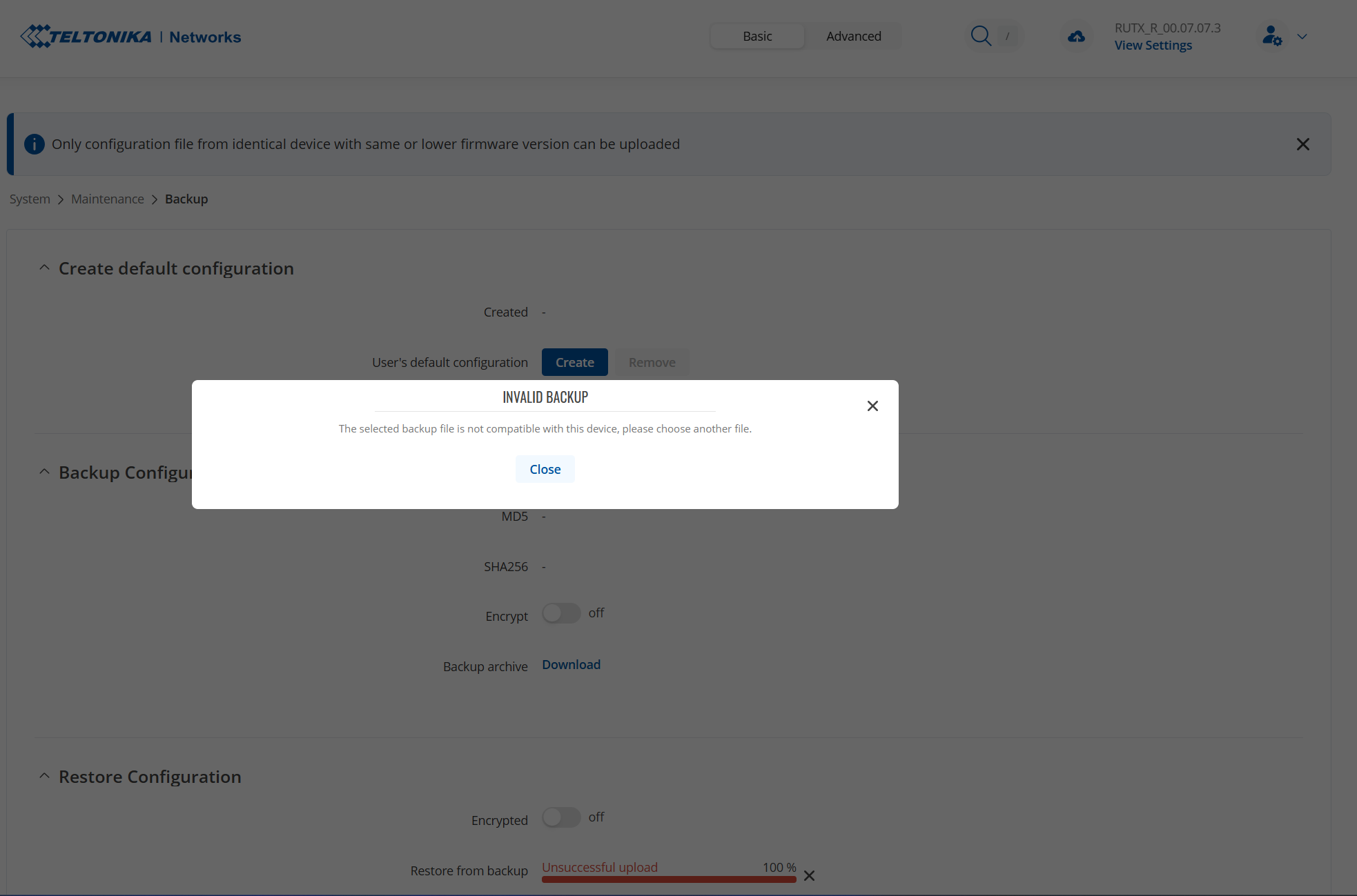

I am currently working with a new RUTX11 US model router and have encountered an issue while attempting to upload an US version backup file to the device. Both the new and previous routers are operating with the same firmware version, RUTX_R_00.07.07.3.

To put it simply, the backup that is being uploaded onto the device needs to have been generated on a device that is:
  • The same firmware
  • The same order code
  • The same model (falls under the order code)
For example, you cannot upload a RUTX11 EU version backup onto a RUTX11 US version.
Once these conditions are met, you should have no issues. For your specific case, the RUTX11 US & EU version codes are as follows:
RUTX11 EU: RUTX11 0*****
RUTX11 US: RUTX11 1 *****; RUTX11 3 *****
A bit more information can be found here: RUTX11 Configuration Backup - Teltonika Networks Wiki
Does this mean that both devices must start the product code in the same way? For example, RUTX11 3***? So I can’t upload a backup file made with RUTX11 1*** product code device?
That would be correct. They both must have the same firmware, and the same order code.
