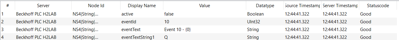

Data types that I was able to successfully read are:
  • Bool
  • Int32
  • UInt32
  • Real
  • ULINT
Data types that I wasn’t able to successfully read are:
  • String
  • DateTime
These variables exist, are readable in UAExpert, and are standard Beckhoff PLC datatypes. UAExpert reads them without issues:
  • STRING(255)
  • DATE_AND_TIME

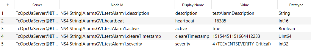

OPC UA Node ID I tried to read:
AlarmsGVL.testAlarm1.description
AlarmsGVL.heartbeat
AlarmsGVL.testAlarm1.active
AlarmsGVL.testAlarm1.cleareTimestamp
AlarmsGVL.testAlarm1.severity
These logs shows the problem clearly:

Some of the Node IDs were read successfully but some just returns empty string
  "error": 0,
  "result": ""
The UA Expert application doesn’t seem to have a problem with reading all data types.
