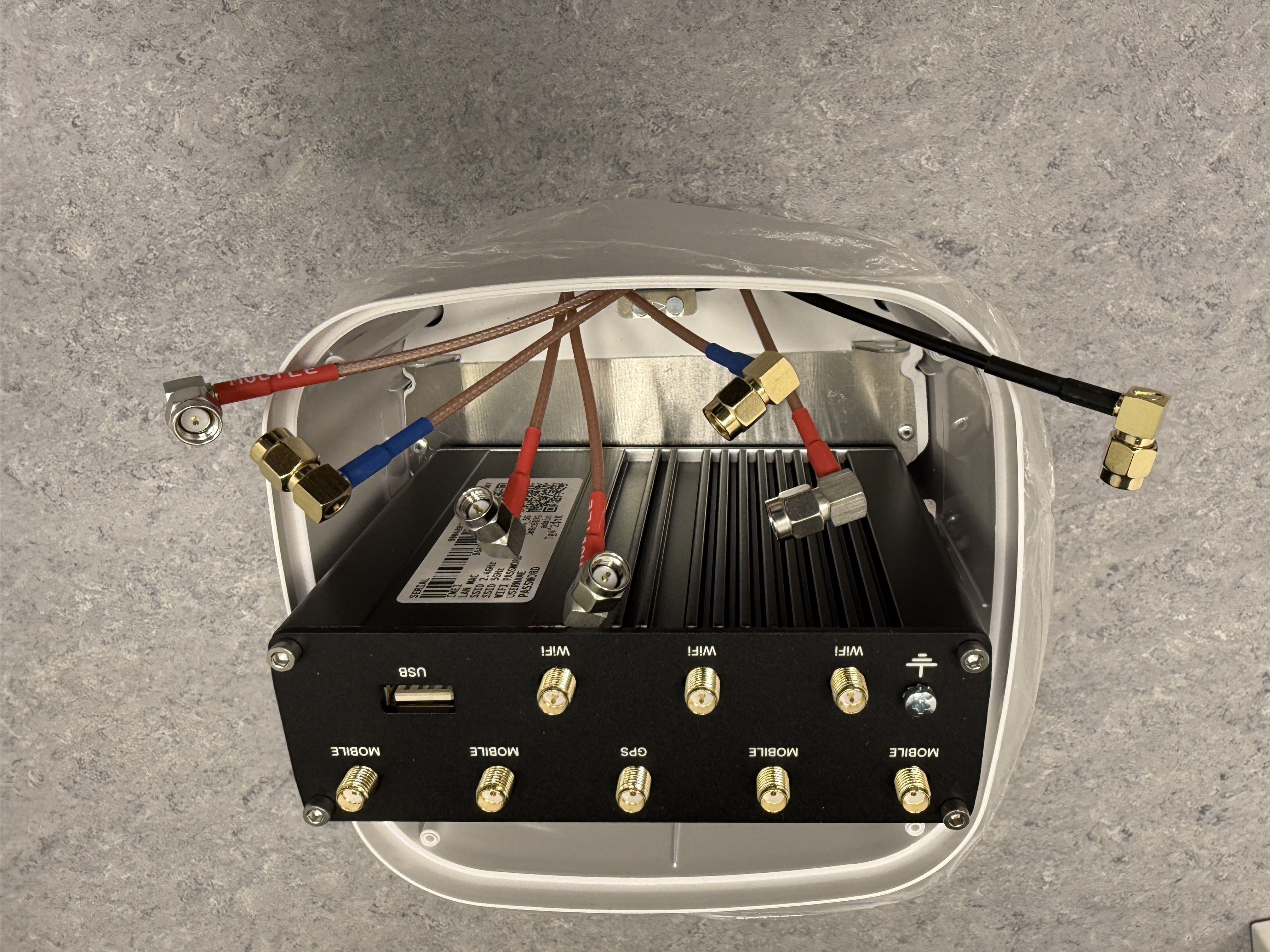

i just bought a pr1ica70 antenna and it says it is compatible with a rutc50, but there is a wifi antenna connection missing in the antenna itself, so i am missing 1 antenna connection since there are 3 connections in the router but only 2 wifi cables in the antenna
Good afternoon,
Can you send a picture of all the connections you have available?

Look at this on your site, it says that RUTC50 is compatible with this antenna, but it is not as when there are missing a mounted WiFi antenna in the pr1ica70 antenna product, there is only 2 and you have 3 WiFi antennas in the RUTC50, in the x50 and m50 they are only 2 antennas to the WiFi, am I missing something here, Can’t finde dokumentation on that solution?
Thank you for sending the photo.
The device has a correct number of antennas, as it has 4 Mobile, 2 Wifi, and one for GPS.
Our RUTX50, RUTM50, and RUTM54 devices are unable to utilize the WIFI6 technology, therefore the antenna suits them perfectly.
RUTC50 can utilize WIFI6 technology, and was also released after we released the antenna, therefore it has an external port to improve the wifi. Note, that with just two antennas you will be able to utilize the technology itself, you just wont be able to achieve the maximum possible WiFi speeds or reliability.

I bought the exakt same configuration as in this topic. I wonder then from the answear abowe wich of the connektors on the rutc50 is best to exclude ore does it not matter?
best regards Par
It does not matter, you just need to connect mobile antenna with mobile port, wifi, with wifi port.
