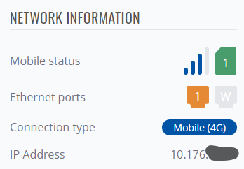

The router see the ip in the pic , but the ip i get from http://checkip.dyndns.com is different , it is 151.99. ###
Hi @gyu9,
if your RUT241 detects a 10.176.x.y or 10.16.x.y
address on its mob1s1a1 interface then it does
NOT have a public ip address but only a CGNAT
(i.e private) one.
You have to talk to your provider and/or check your
APN settings.
