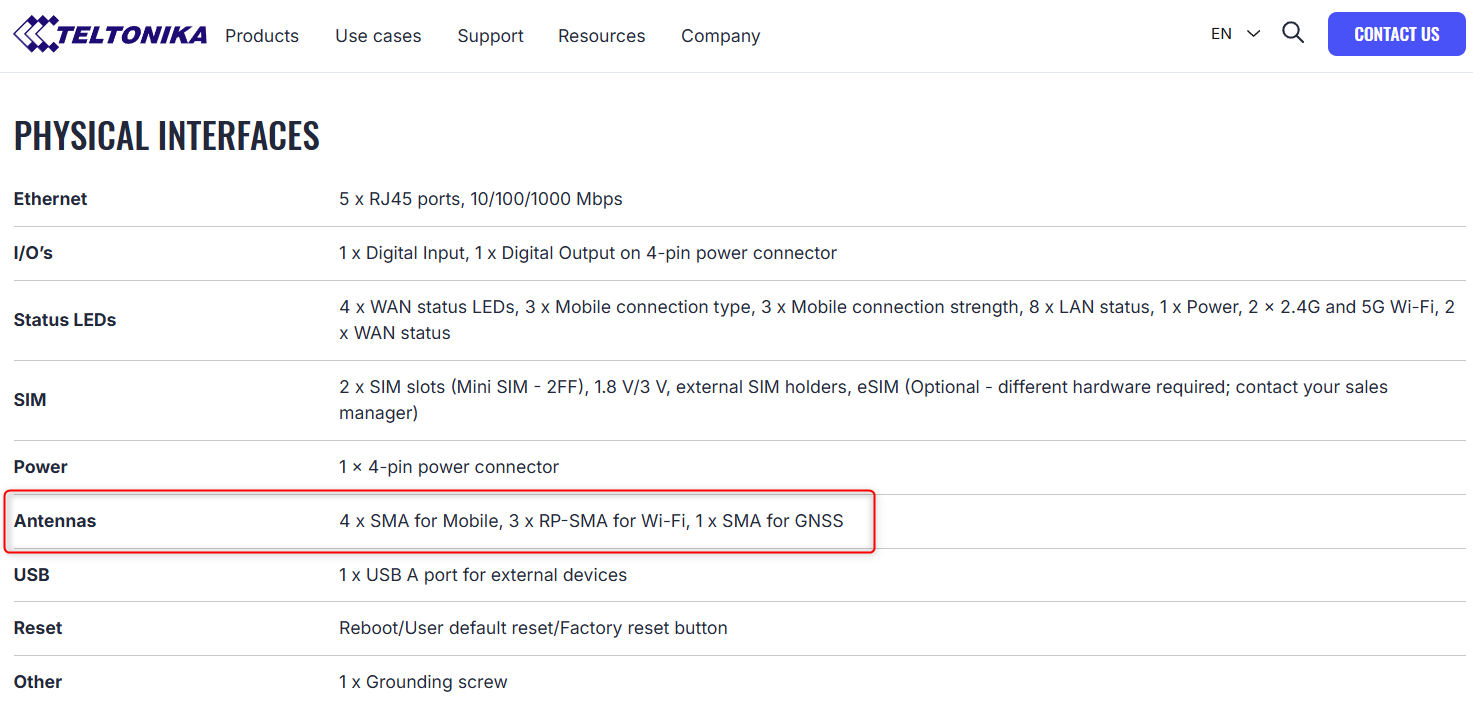

Additionally, please make sure that the antenna connector is compatible with the connector on your device before purchasing. You can find more information on the specifications of Teltonika antennas on our official Teltonika Networks website in the features tab:
