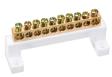

I just use a fuse and a Terminal Block connector… (two)…
Like this…
I know… very simple… but… it is just for a personal usage… so… It is working, very well.
Thanks again. Great to know it works that way. Something like with but with dual 4 pin plugs instead of a terminal block would be perfect. Then we could use the standard accessories available.
