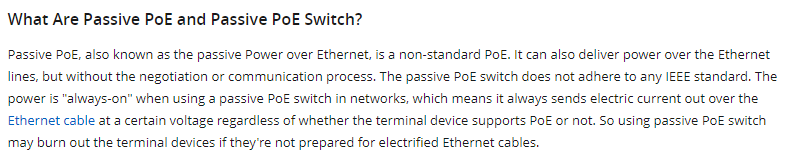

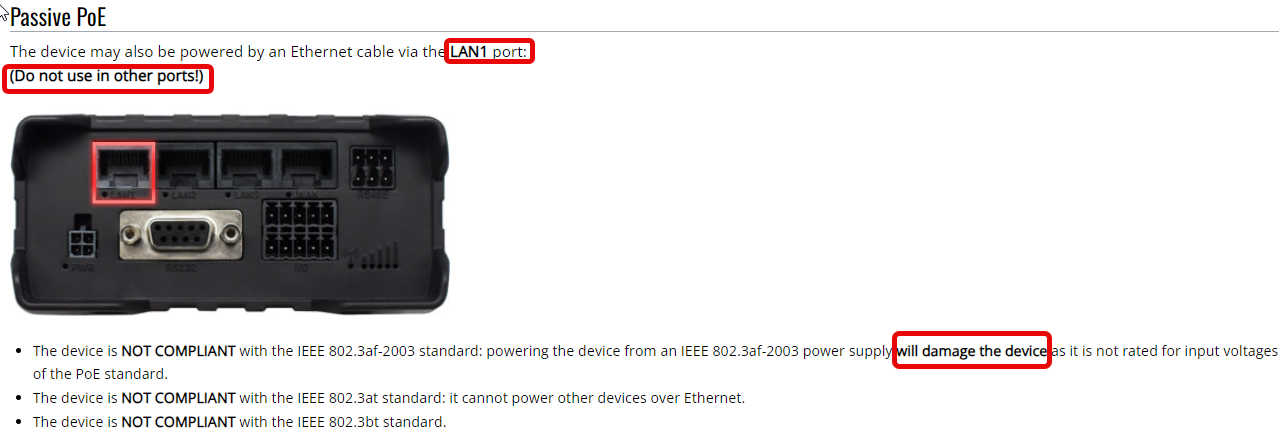

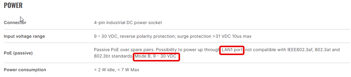

As long as you attempt to power the device over passive PoE with 9-30VDC the device should operate as intended. Anything above 30VDC will damage the device.
Any Passive PoE injector that delivers in-range voltage (I use 24v) AND IS ABLE TO deliver the wattage required … see spec of router for maximum power draw of device.
