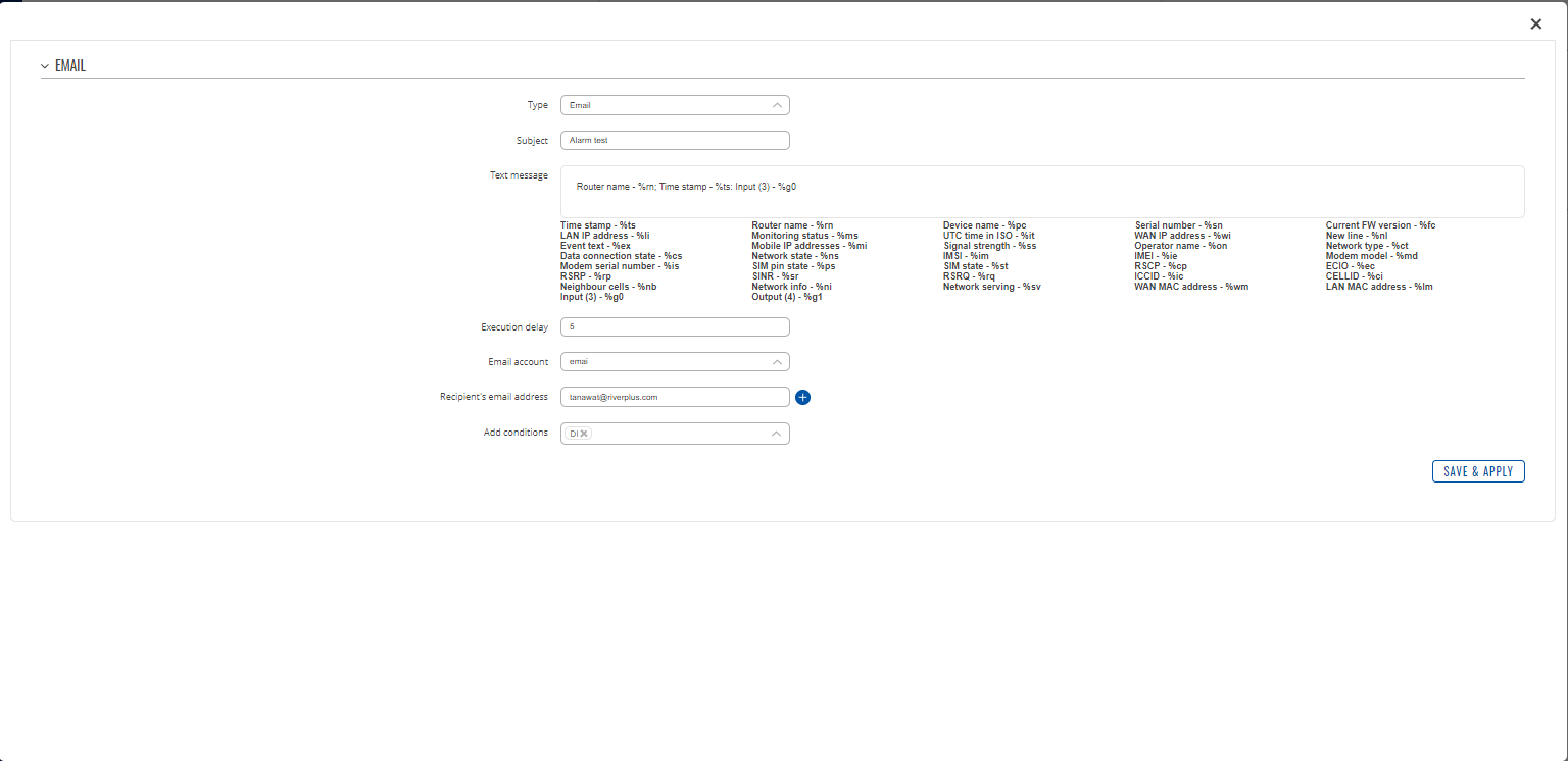

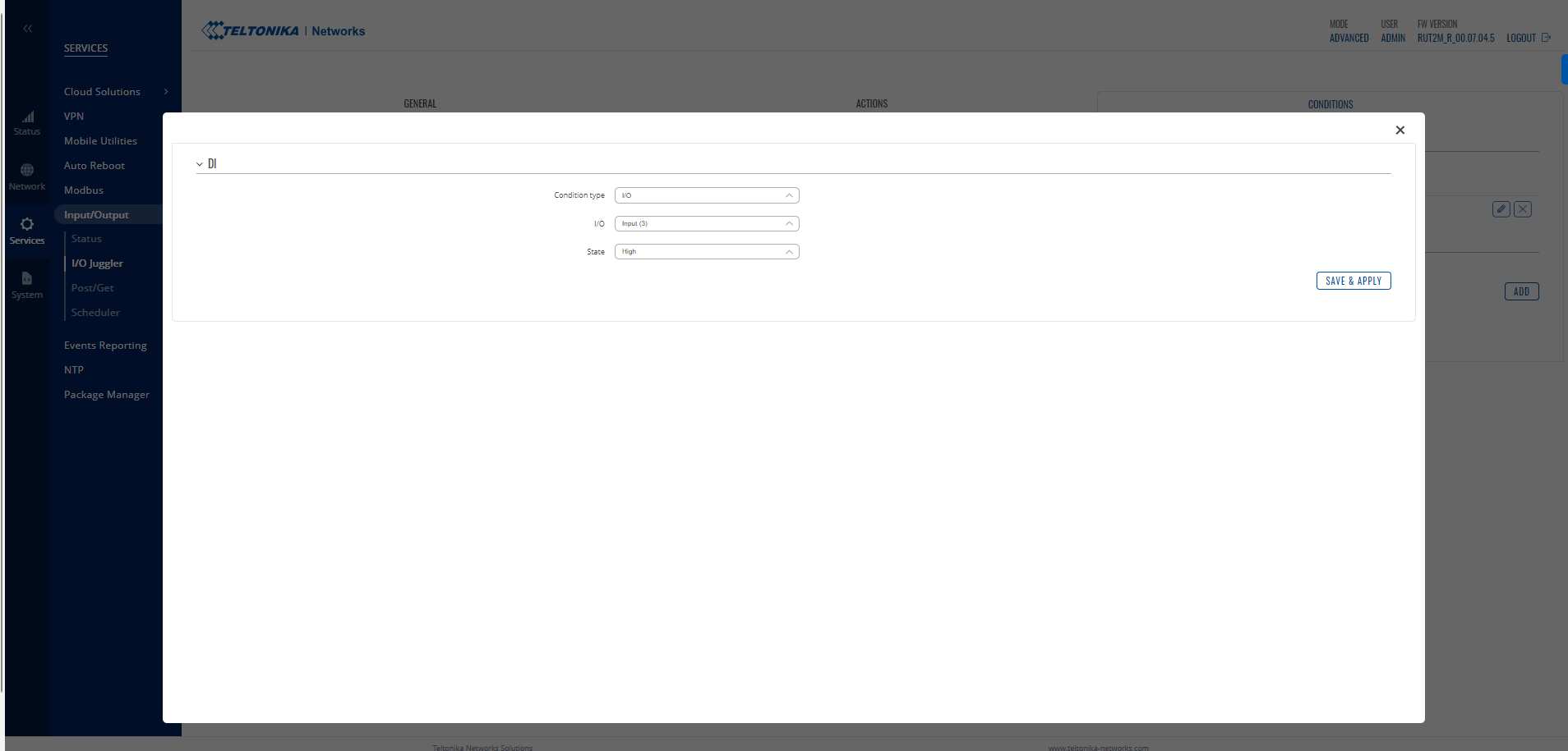

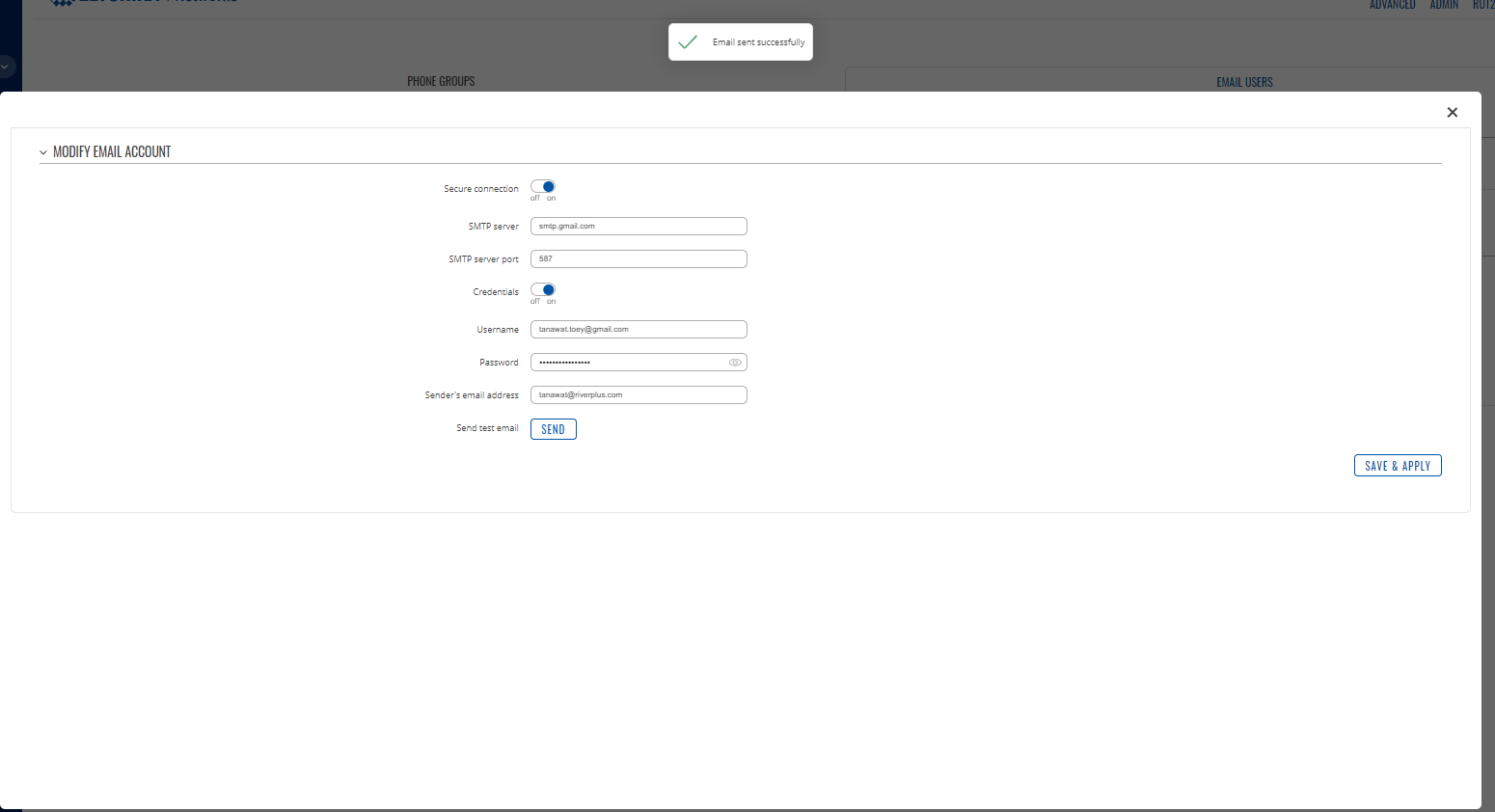

both sms and email not send when condition trigger
Can you remote to check my config?
Remote session is not possible, as private communication is not possible on this forum. Please clarify how you have configured the SMS rule and attach the screenshots. Thank you.
Condition setting
SMS Action setting
email action setting
Please try sending an SMS by navigating to Services → Mobile utilities → Messages → Send Messages.
If that works, please reconfigure the I/O Juggler as follows:
  • In the Actions tab, create a new instance with Type as Email. Reconfigure everything as per your screenshot.
  • Also in the Actions tab, create a new instance with Type as SMS. Once again, reconfigure the Text message field and recipient. Leave the Conditions field empty for testing.
  • Back in the General tab, create a new instance with Input (3) as the role. Select the previously created actions, trigger, and enable the instance.
This should be enough to receive an SMS and an Email once the input pin is supplied the voltage.
