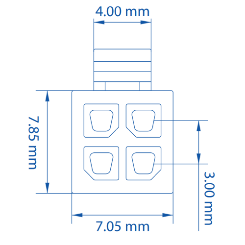

I have a rutx50 where we ripped the little nose where the cable Plug holds onto.
So its no longer secured. I like to replace it If possible.
Are you referring to the power socket (router side) or the 4 pin power plug (cable side)?
Router side

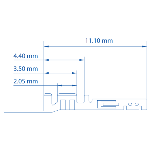

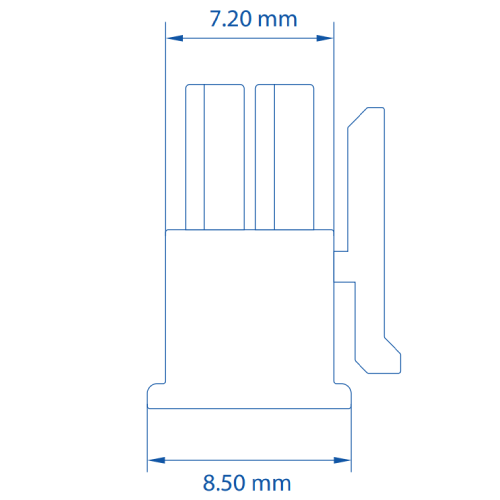

They look similar to a Molex Micro-Fit 3.0 … have a look on the molex site and compare the dimensions.
Below are the dimensions for the Teltonika Plug, to make a comparison.
