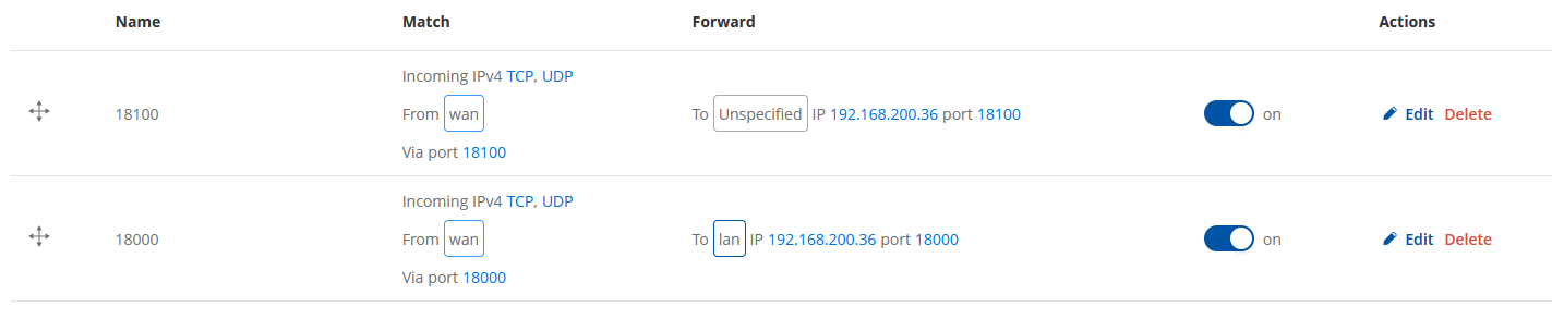

Hi, Thank you for the replay but i have the ipsec set up and working . i need to recive data on port 18100 on the teltonika router and forward in the ipsec to an network service on the other end, as diagram below i have this set up on Conel routers but i want to start using teltonika routers.
When i ping the service fron the lan on the teltonika router i get replay, but it dont work with the portforwarding to the ipsec tunnel
IPsec will not be the best VPN to use for this use case, but we can still try configuring it. Assuming the “Incoming data on Port 18100” is on the WAN side, you can try editing your first rule to forward the traffic to the WAN zone, as that is where IPsec is considered to be in (currently no destination zone is chosen).

That’s right it is on the WAN side, Yes, 192.168.200.36 is the datacenters ipadress .
I tried to change the forwarding zone to WAN Zone but its did not work.
