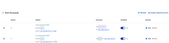

I updated my RUT241 to RUT2M_R_00.07.17.1.
I am using vlans in my local network and not the default ‘LAN’
Old rules are working as they have the correct VLAN assigned. A new rule has the LAN assigned and in the edit window it is not possible to change this.
I edited the /etc/config/firewall file and added option dest ‘vlan1001’ now it is working.

I have a dedicated firewall zone vlan1001
