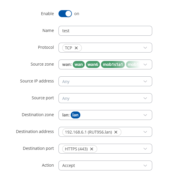

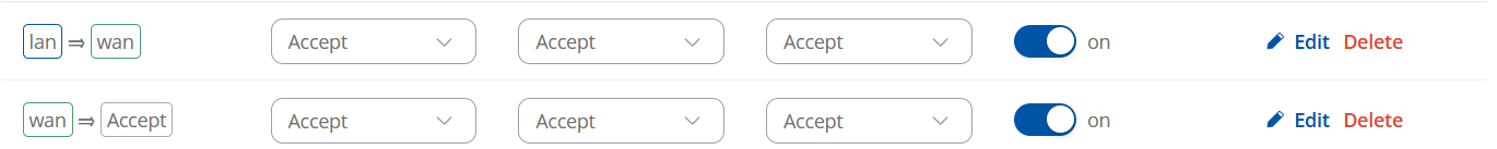

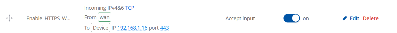

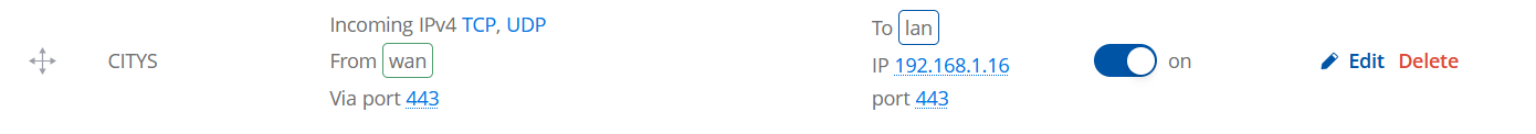

I’m trying to do a port fowarding from the WAn to the LAN for a RUT200 router.
I try to connect my device with the ‘443’ port but nothing is happened. I have trying this with the WAN port (from my entreprise LAN) and the Mobile network (with DDNS) without success.
You can find my router’s configuration below :

Has someone seen something wrong in these parameters ?

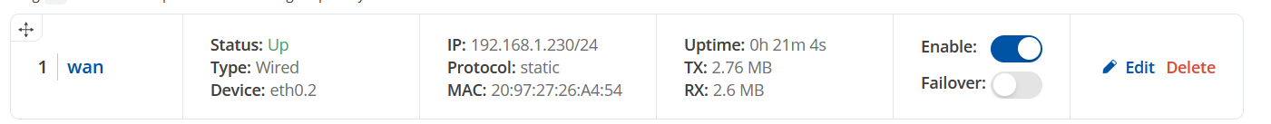

The biggest issue that I see is that your WAN and LAN interfaces have same subnet. This will cause routing issues. I suggest changing your LAN ip to 192.168.2.1 or something else and check if it helps

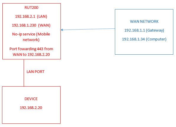

Could you please provide a network topology diagram including the devices and their IP addresses? This will help us better understand your setup.
Thanks for your reply.
You can find below the network diagram :
Thanks for your help,
Best regards.
Ben

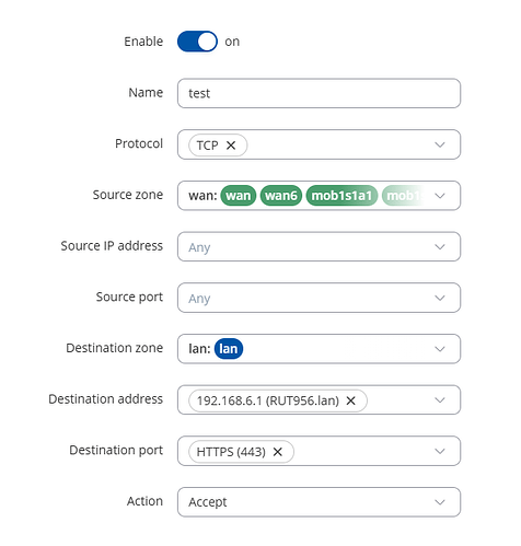

Could you please remove the traffic rules you have created and try adding a new one with the following settings:
Let me know if this helps you achieve the desired outcome or if you still encounter any issues.
