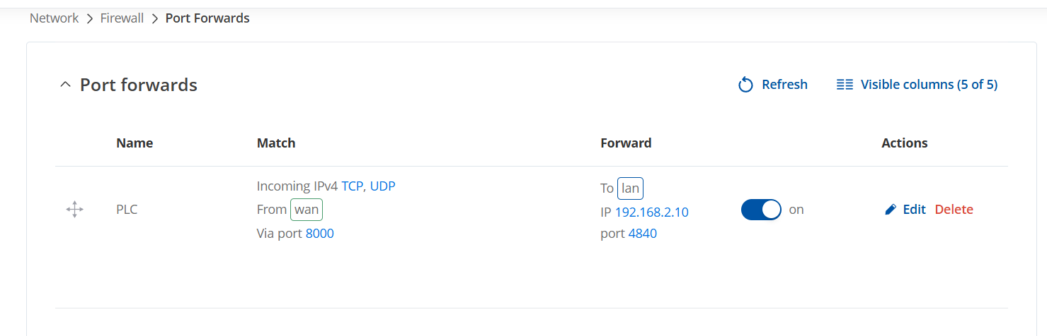

In this TRB setup, we are using a SIM card to connect to the internet. Since the IP address provided by the internet provider is dynamic, I created a DDNS (Dynamic DNS) and it is running.
After that, I configured port forwarding from port 8000 to the OPC UA port of the S7-1200 PLC, which in my case is 4840.

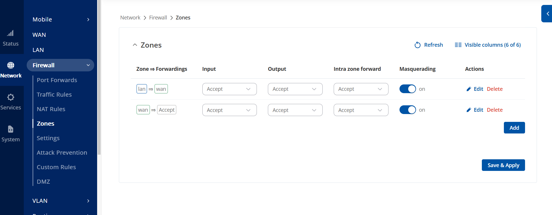

In the “Zones” section, I enabled the masquerading option.

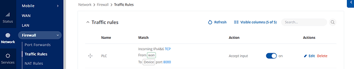

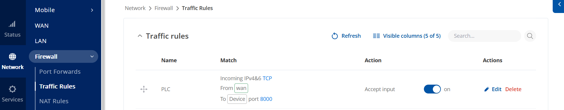

In the “Traffic Rules” section, I added a rule to “Open ports on router” for port 8000.

Firstly, I would strongly recommend setting WAN => Accept zone Input to Reject or Drop. If you have a public IP address, this is insecure.
Secondly, you have port-forwarding rule configured correctly (assuming ports and IP is correct). This will work without additional “Traffic Rules”. I recommend deleting the “PLC” traffic rule and restarting firewall/device.

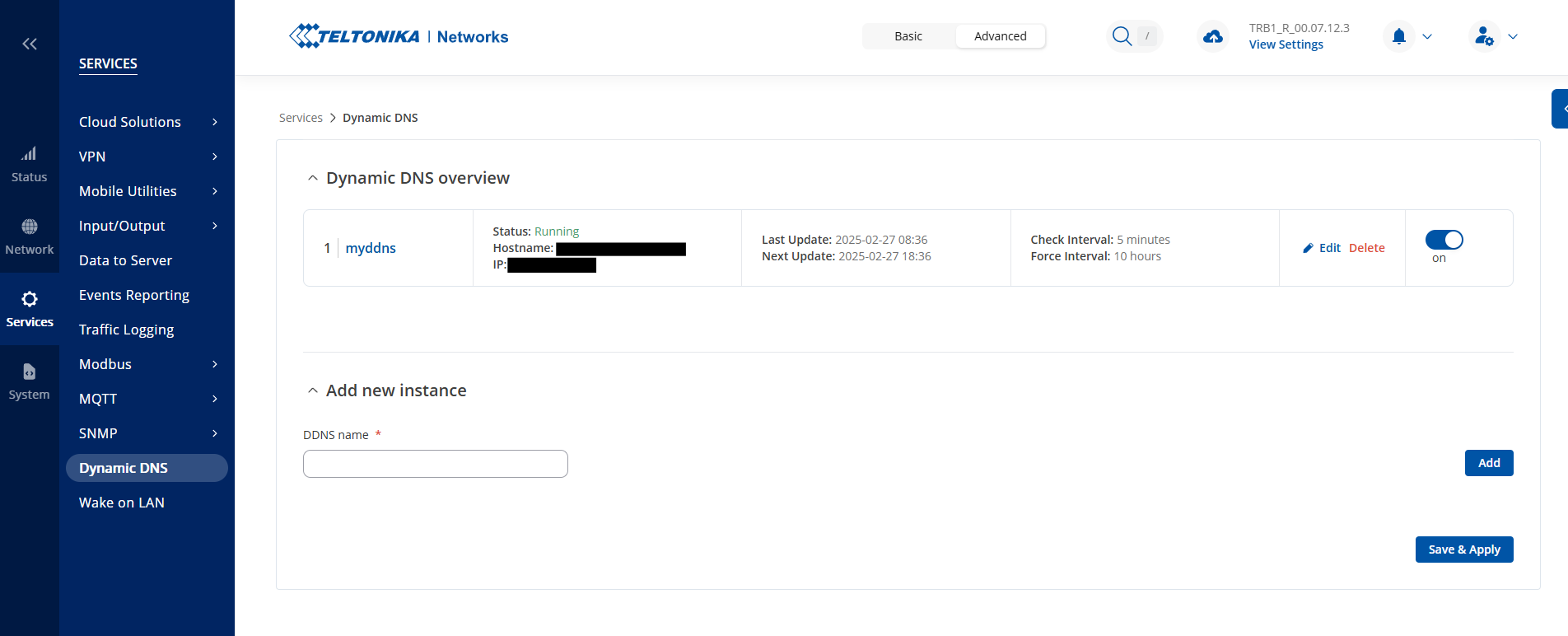

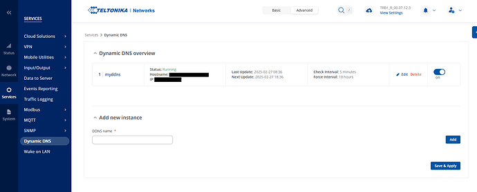

If the issue persists, could you please try enabling remote HTTP access in System → Administration → Access Control and trying to access the RUT itself from the internet using its DDNS? Does it connect?
Thank you for your suggestions.
I have changed the WAN settings as you recommended, deleted the “PLC” traffic rule, and enabled remote HTTP access, but I’m still unable to access the TRB from the internet using the DDNS.

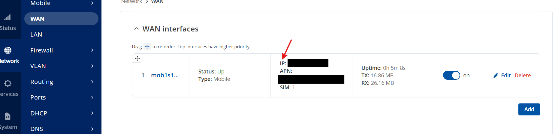

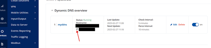

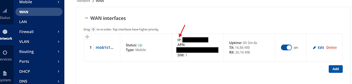

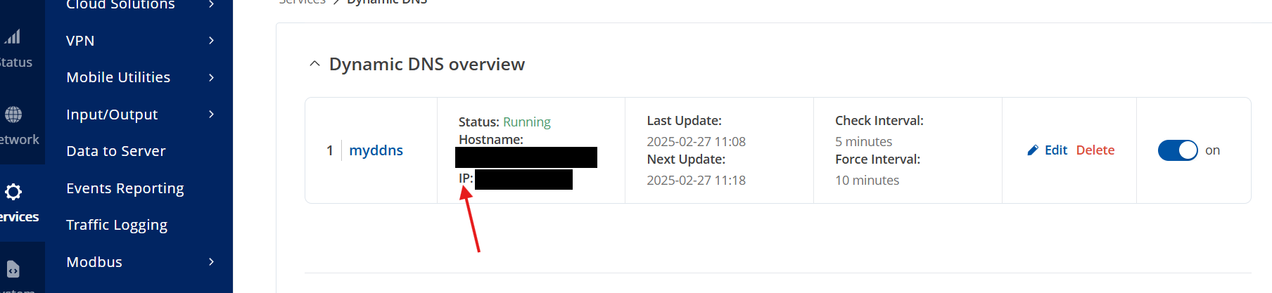

Additionally, is it normal for the DDNS IP address and the WAN IP address to be different?
Best regrads.
No, those IPs should be the same. If they are different, it likely means your device has either a private IP or a CGNAT IP, which makes it inaccessible from the internet.
