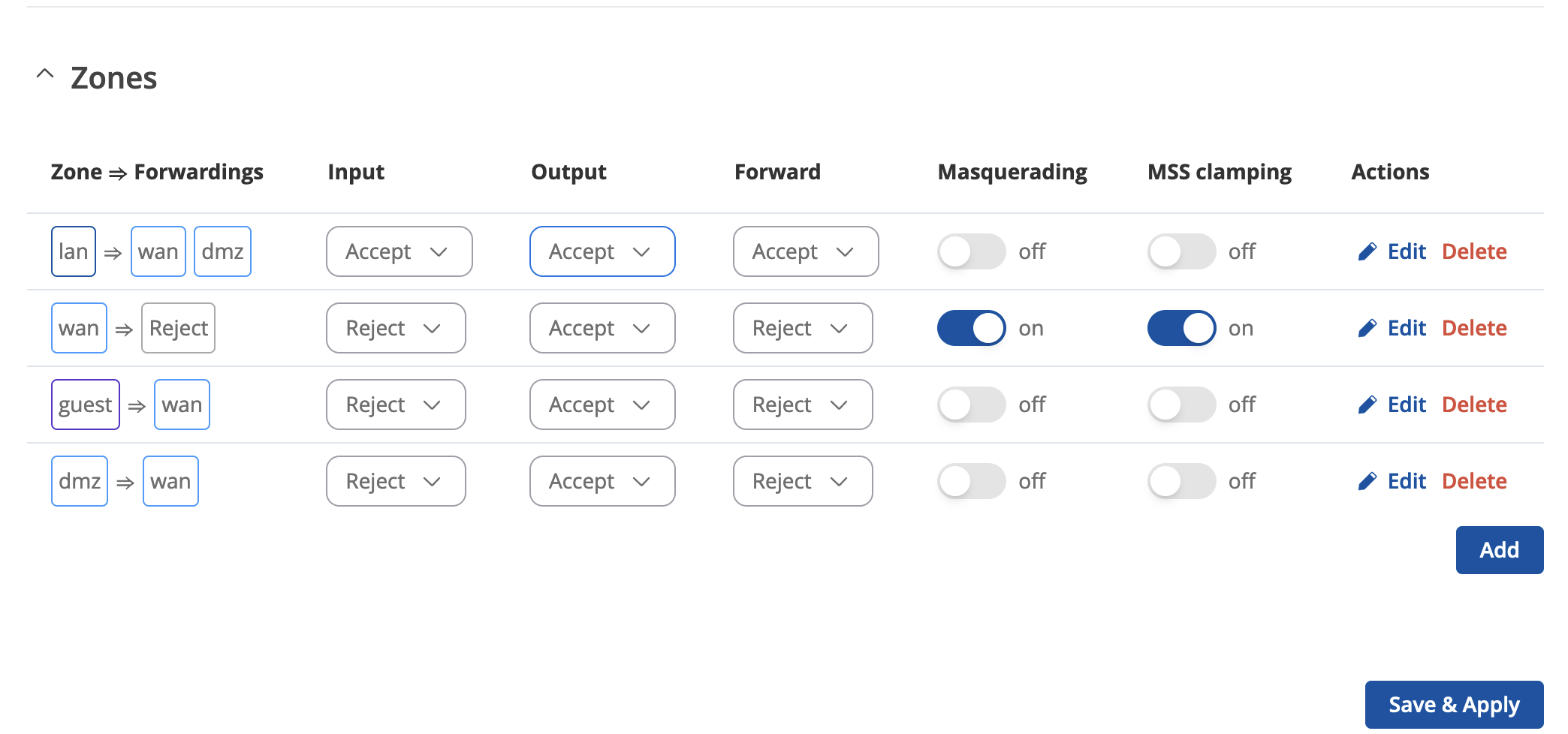

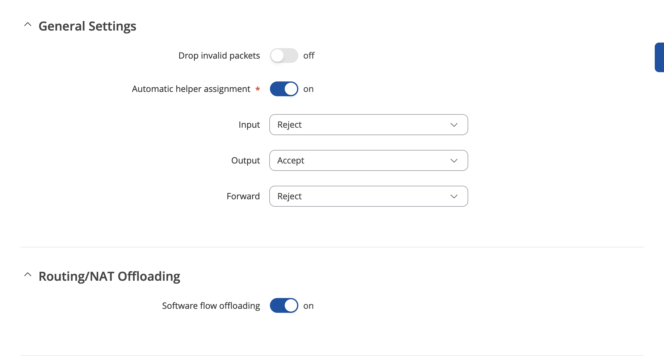

Sure! This is my firewall configuration:

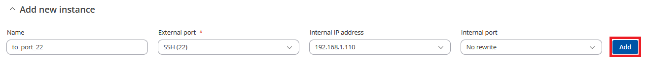

- Configure a new port rule instance as shown below. The internal IP address should be the device’s IP to which the port needs forwarding. Click “Add.”

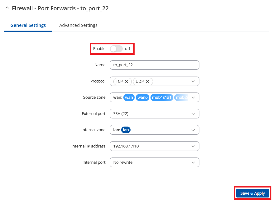

- In the new pop-up window, enable the rule by turning on the “Enable” slider and press “Save & Apply.”

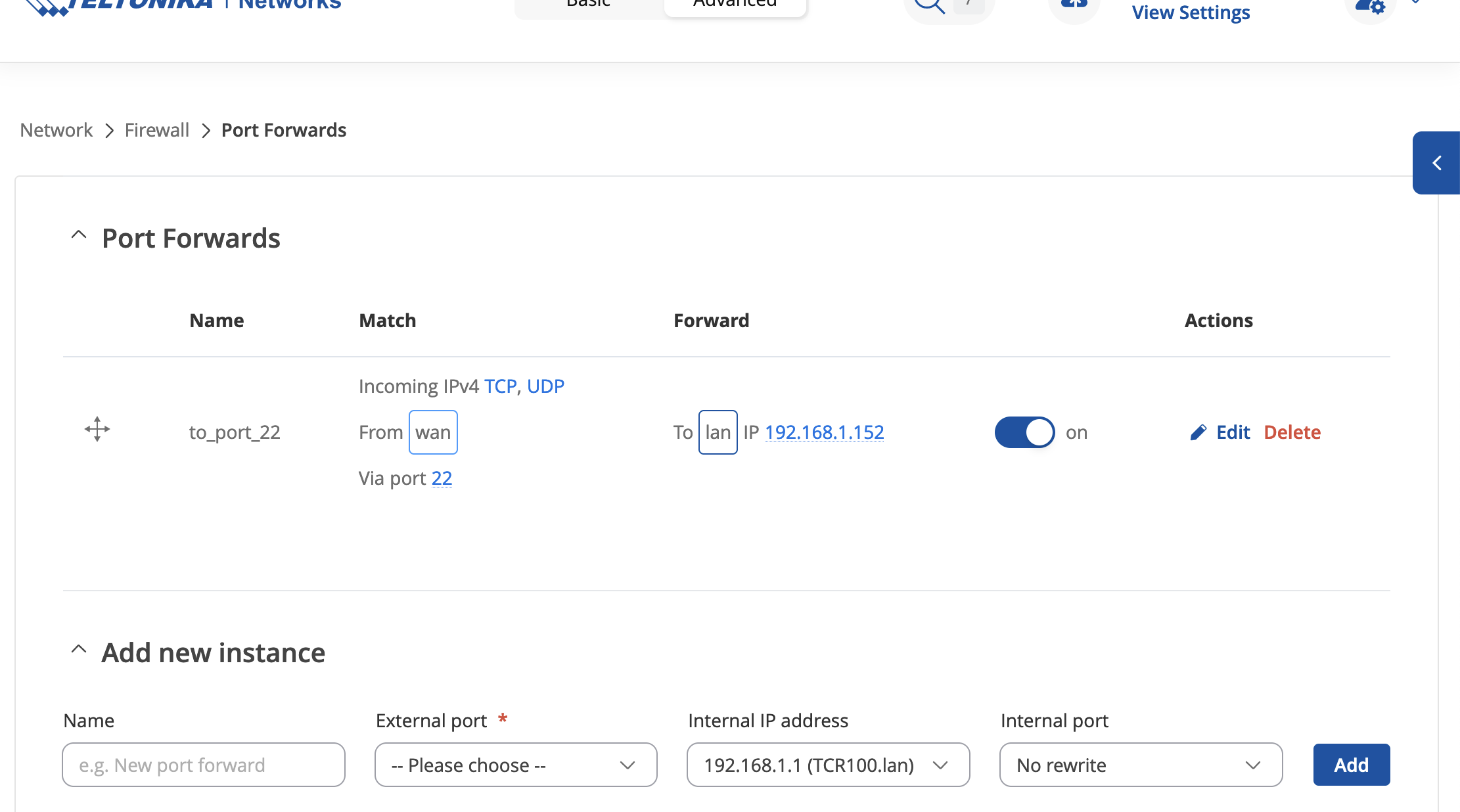

- The generated rule should look like this.

This is my port-forwarding configuration:
I understand you don’t want to access your router directly. However, for port forwarding to a specific port, the port needs to be open. “Remote SSH access” typically opens Port 22 on the router, allowing it to be forwarded.
Based on your traffic rules, it seems like everything should be set up to work properly. Just “Remote SSH Access” needs to be enabled.
