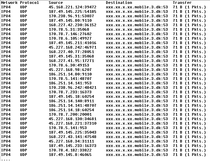

In the RUTOS Web interface I can list current connections to TRB140. After a few seconds there are more than 1000 connections to port 53 from IP addresses all over the world (primarily CH, BR etc.). In TRB140 port 53 seems to be blocked from WAN (doesn’t show up as an open port when running an NMAP scan), but still I think all these DNS requests are counting as data usage on the cellular network. At least this is the only explanation I can find for the excessive data usage. The data usage is approx. 9 MB per hour, i.e. more than 6 GB per month.
Here is an extract of the list of connections (xxx.xx.x.xx is the public IP address of TRB140):

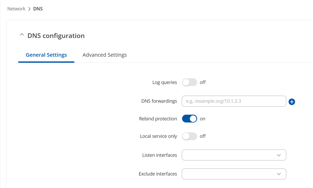

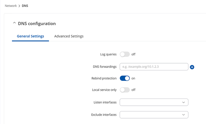

I have already configured the Firewall with all the available attack prevention options enabled. I have also set up “DNS” to what is shown below, but it didn’t have any effect on the data usage.
My DNS settings look like this.

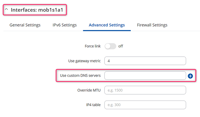

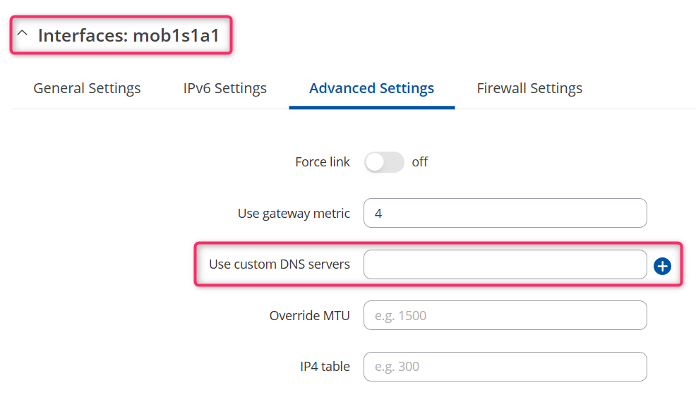

All default - with no custom DNS servers on mobile interface - means using ISP assigned DNS servers.

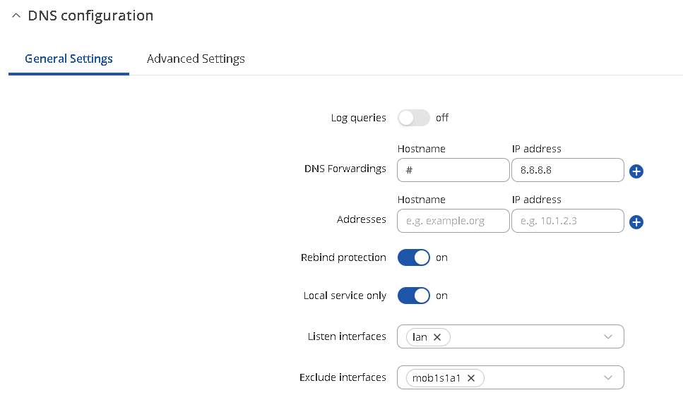

  1. I only changed to Google DNS (8.8.8.8) in an attempt to see if it made any difference and it didn’t.
