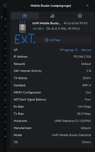

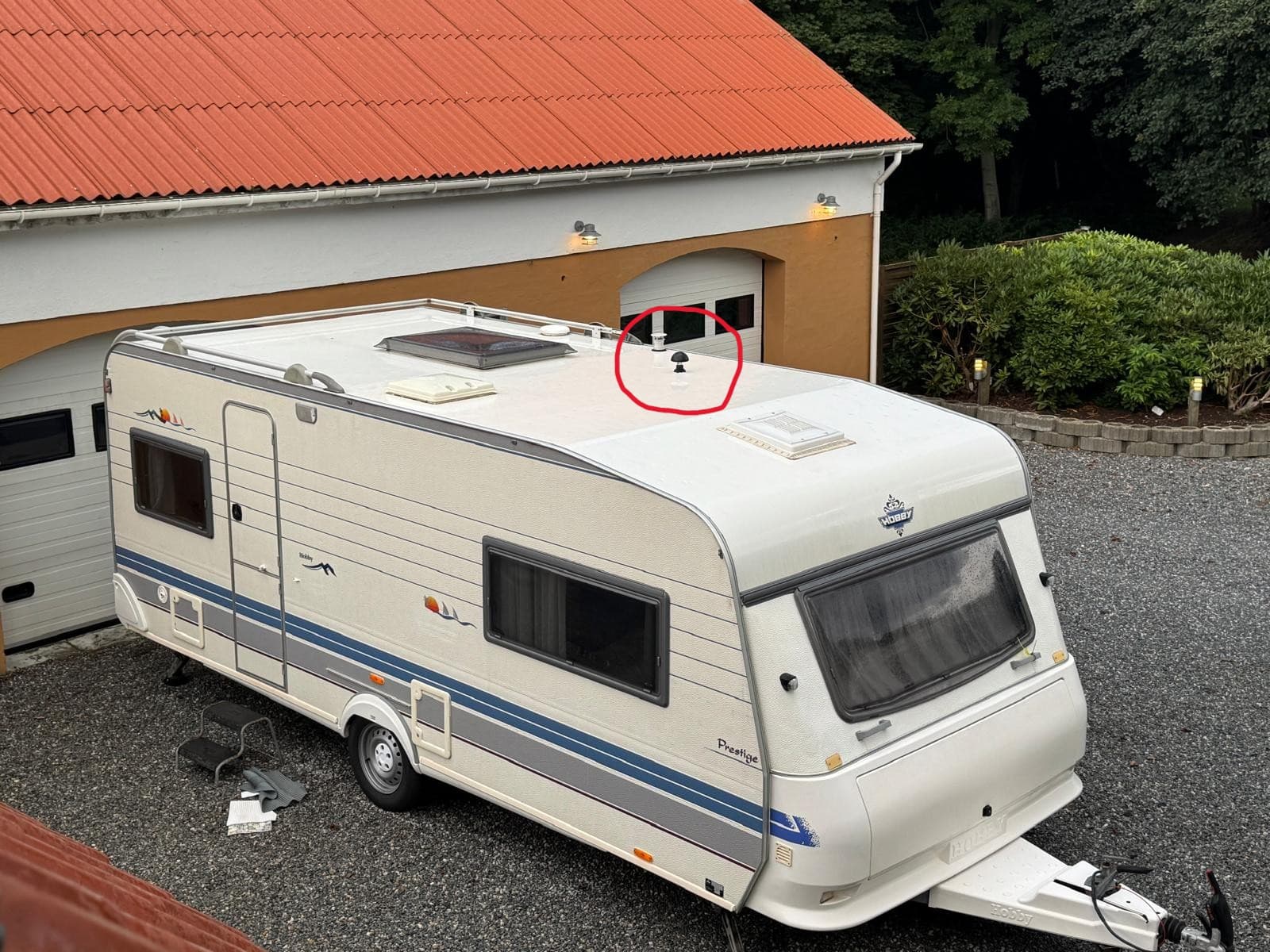

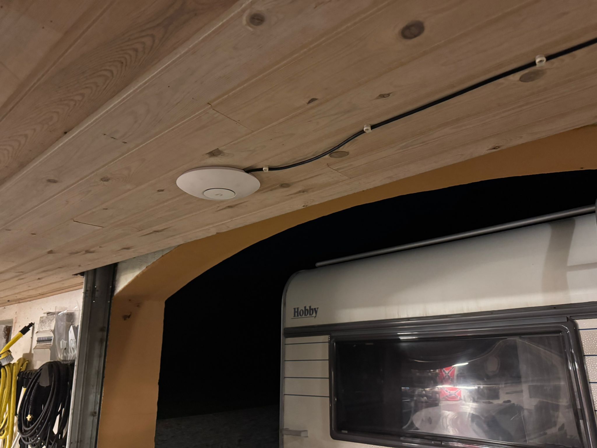

I have installed a UniFi UMR-Industrial 4G router in my caravan and mounted a PR1KCO28 combo antenna on the roof. Router is capable of using nearby WiFi as WAN and the access point is only 4-5 meters aways in an open garage, ceiling mounted facing downwards.

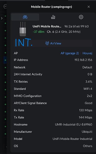

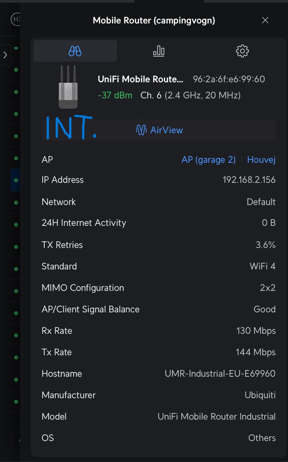

Using the built-in antennas I get a signal of approximately -40 dBm on the router.
Connecting the external Teltonika antennas causing the signal to drop to -65 dBm and Tx retries explode.
I see similar, poor performance when using LTE WAN.

When using the external antenna, the router connects on a 40 MHz channel bandwidth, which explains why the signal appears noticeably weaker. This is because signal strength and coverage depend on the selected wireless channel bandwidth, the wider the channel, the more throughput you can achieve, but the signal propagation tends to degrade compared to 20 MHz.
The default internal antennas supplied with your router only support 20 MHz bandwidth, so you wouldn’t notice this effect with them.
In your case, I’d suggest trying to set the AP’s channel bandwidth to 20 MHz. I expect that with the PR1KCO28 external antenna, the signal strength and stability should improve under this configuration.
Let me know how it goes.
This doesn’t seem to make any difference. I am still getting -69dBm on 20MHz width.
