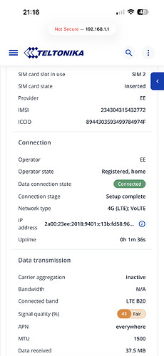

Could you please try putting the card into SIM 2 slot, then navigate to Network → Mobile → General and set SIM2 as the default SIM:
Let me know if there is any difference using the second SIM slot, you can check if the router detects the SIM in Status → Network → Mobile page.

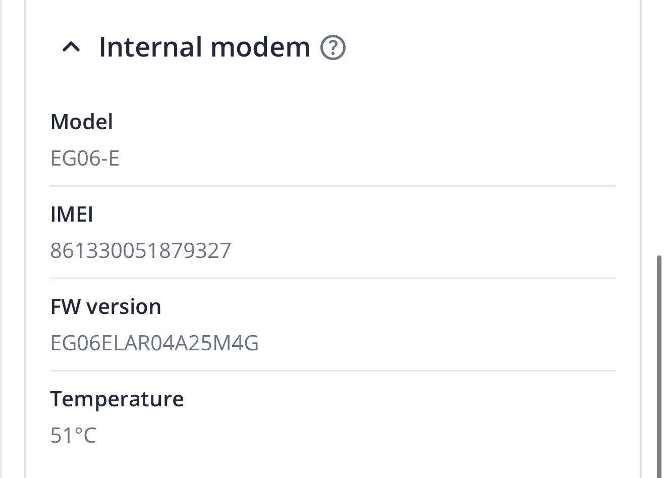

Additionally, could you please clarify what the current modem firmware version on your device is? You can find it under Status → System → Internal modem

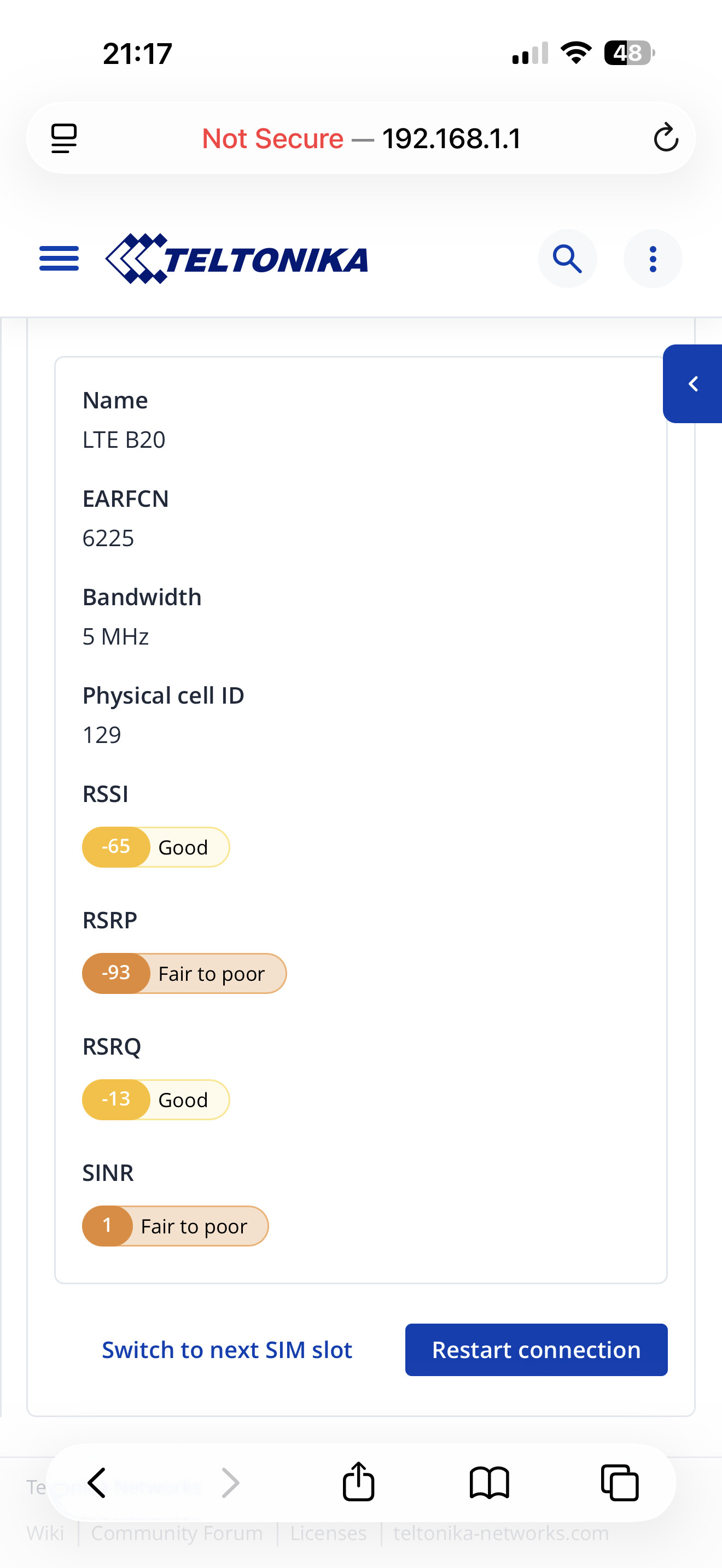

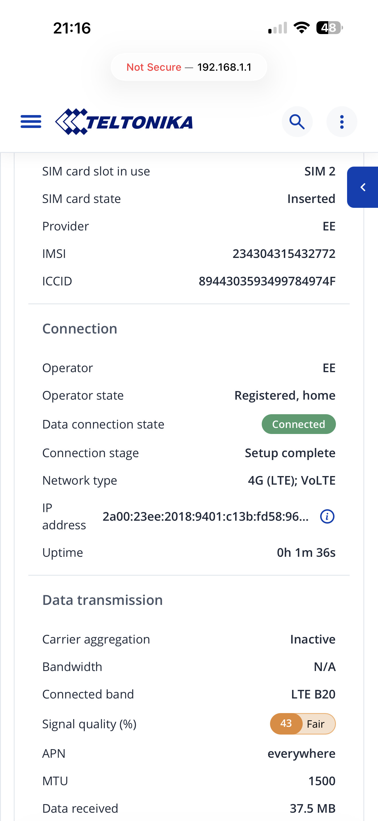

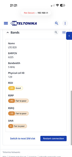

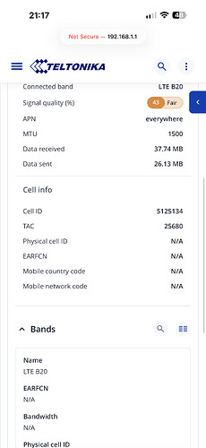

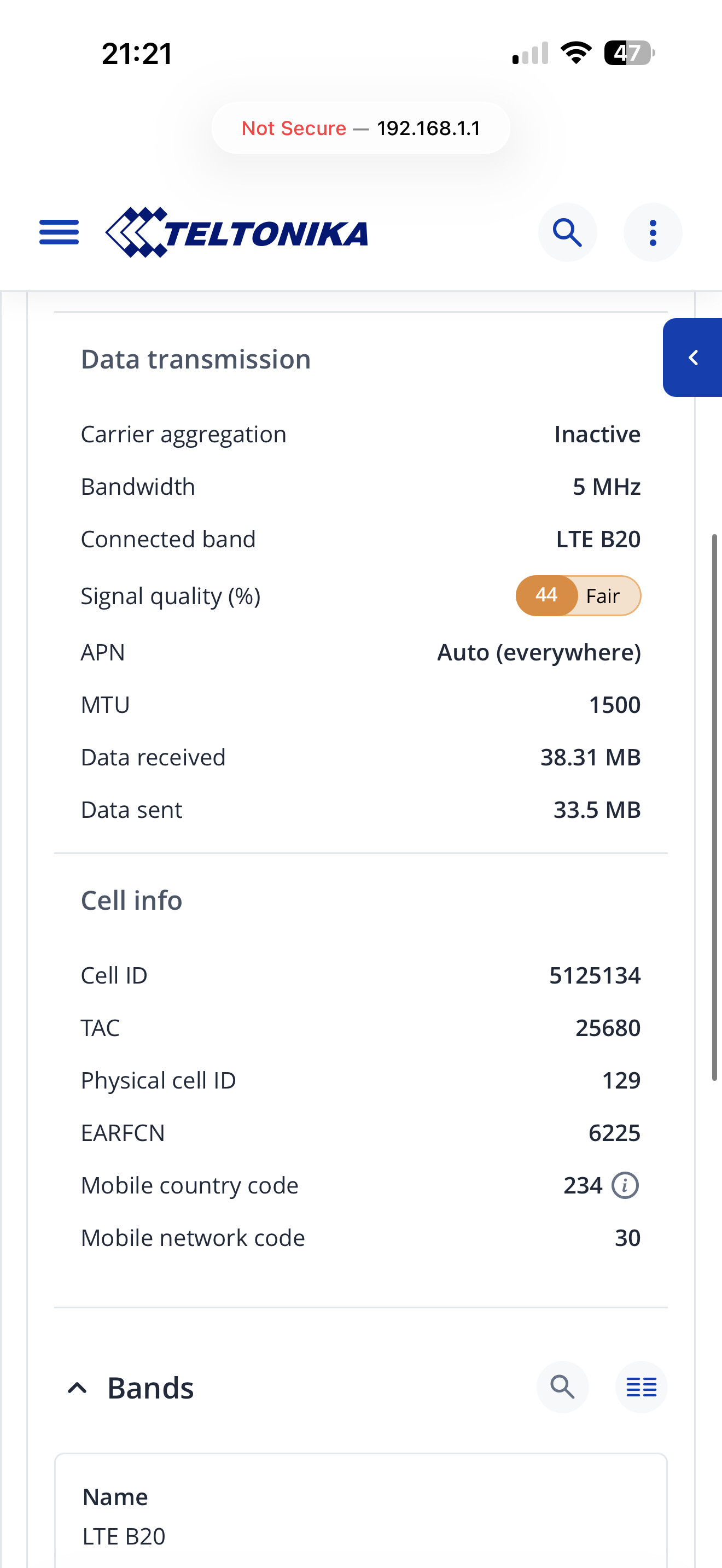

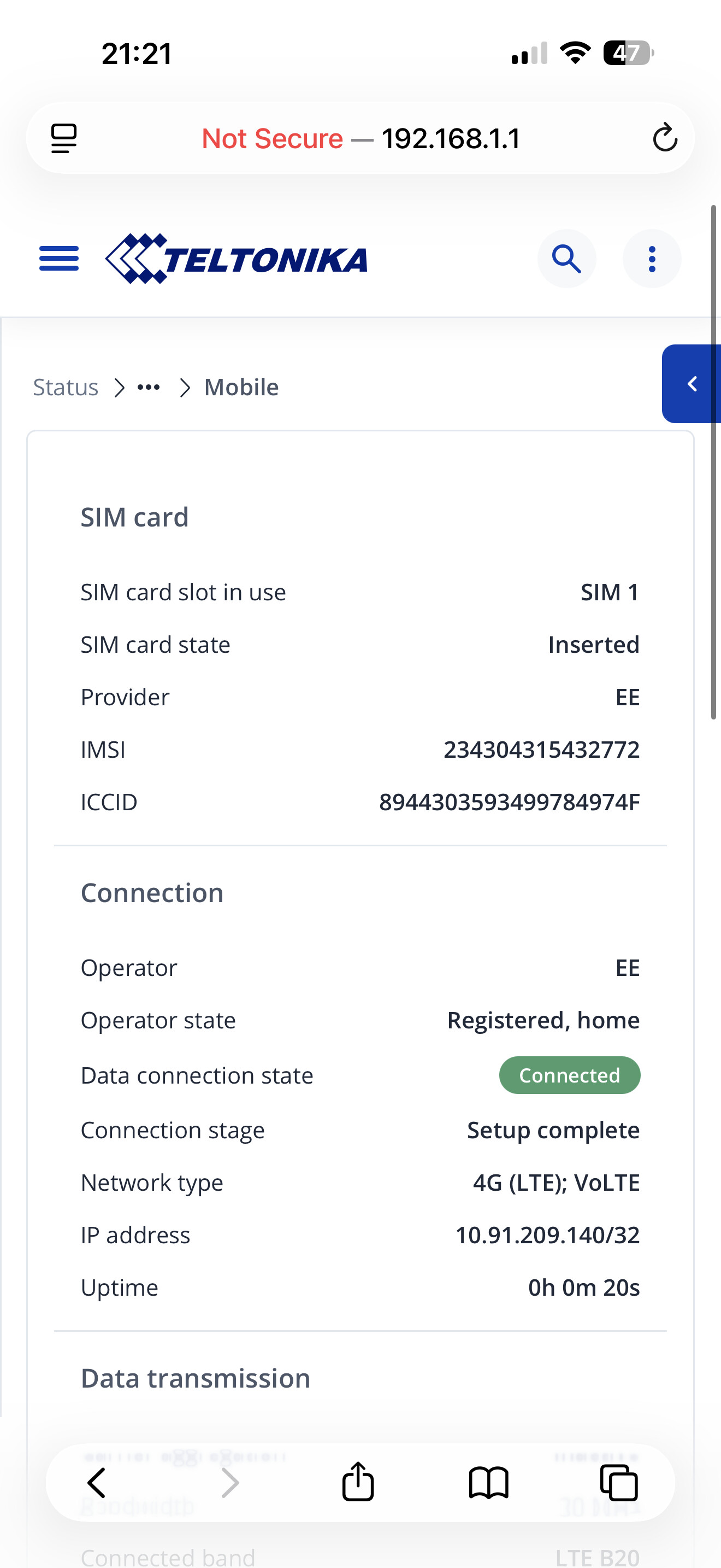

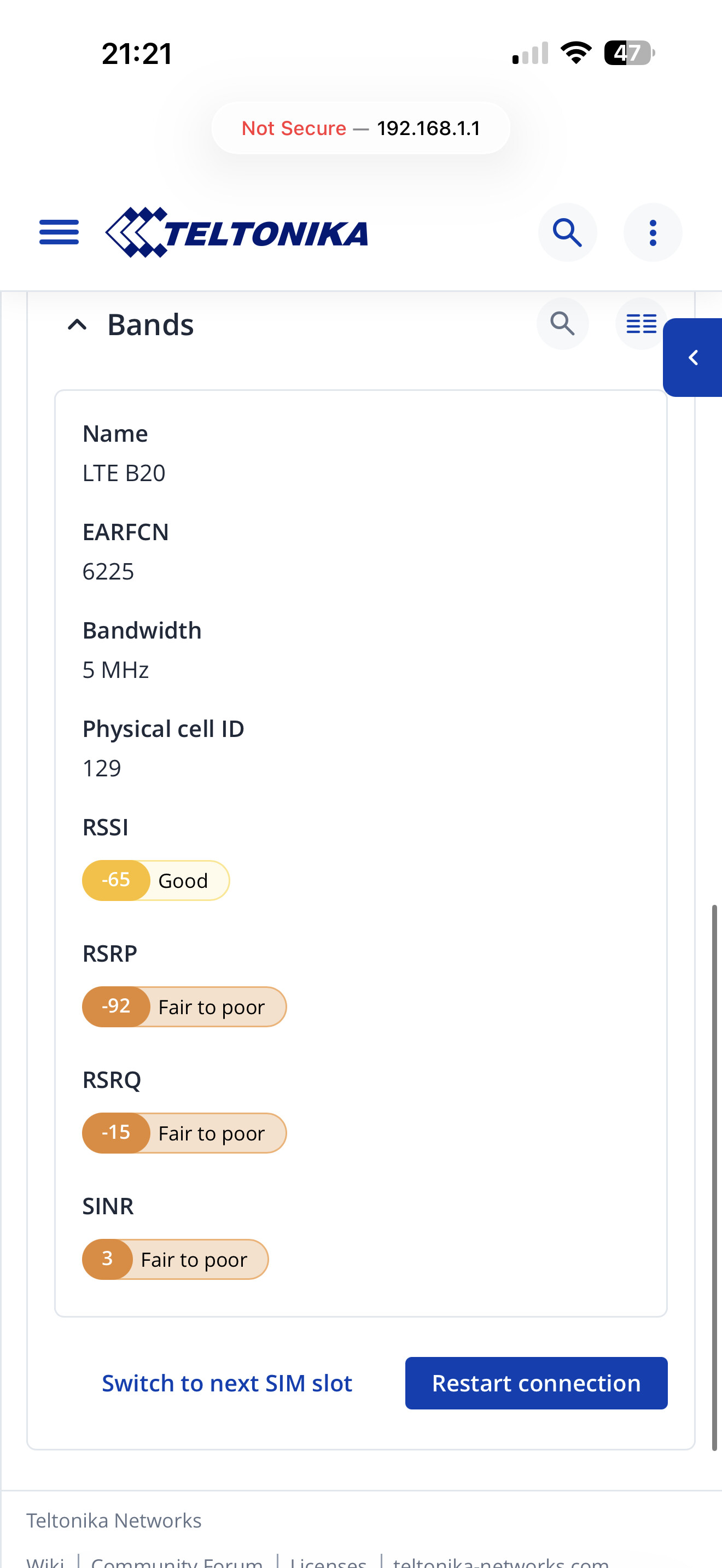

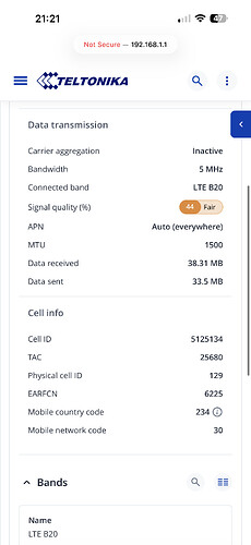

Thank you for popping in, I have attached the requested info.

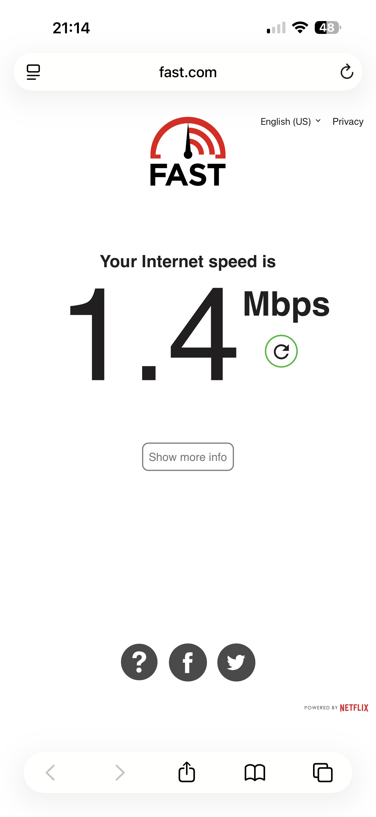

I also tried the SIM2 method but was still seeing about 1.2mb connection, and it dropping out and back in again.
Hopefully the attached helps
Internal Modem temp at 23:00 is 44 degrees
