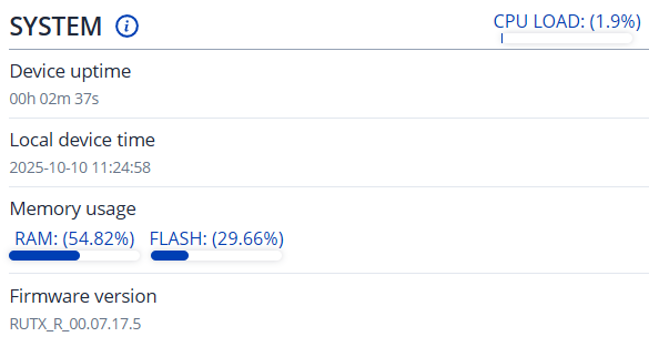

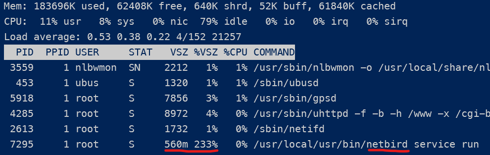

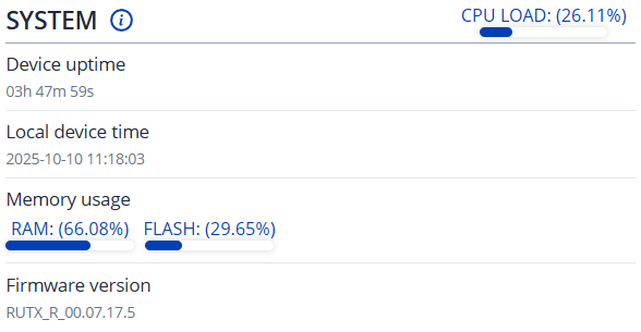

Indeed it takes some my memory on my rutx50 but for my usage it is working fine for more than 4 months.
I used it as a gateway to the services i am hosting on raspberry on my boat.
with and without the netbird services started.
not a big deal but it would be nice to not have to reinstall it every time i install a new firmware.

Could you please tell me which version of the client you installed? I installed the version 0.54
With this my total RAM usage was around 80% and it kept crashing. But when it was working, i could connect to device without problem.
