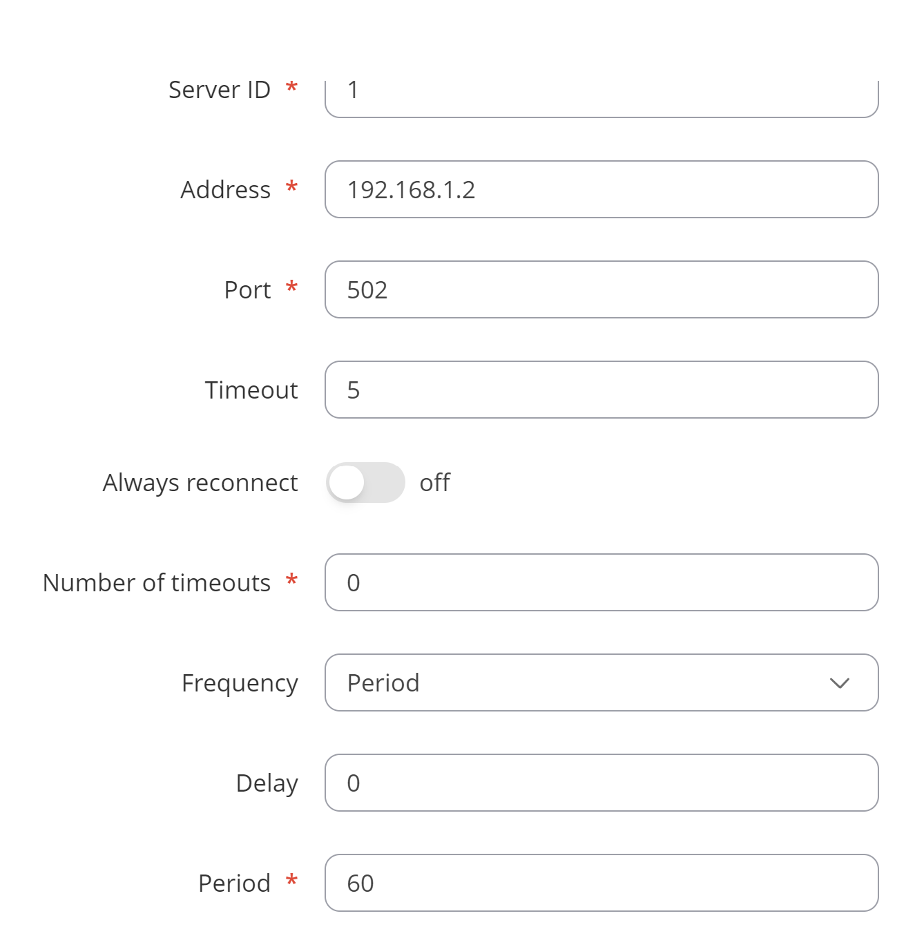

Modbus TCP client device config:

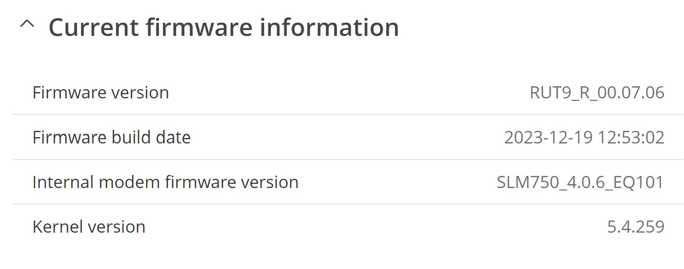

Version:

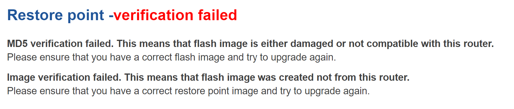

Before downgrade I took a backup but when I try to restore I get this error:
Now I have to manually setup everything from scratch on this router, which is really bad.
