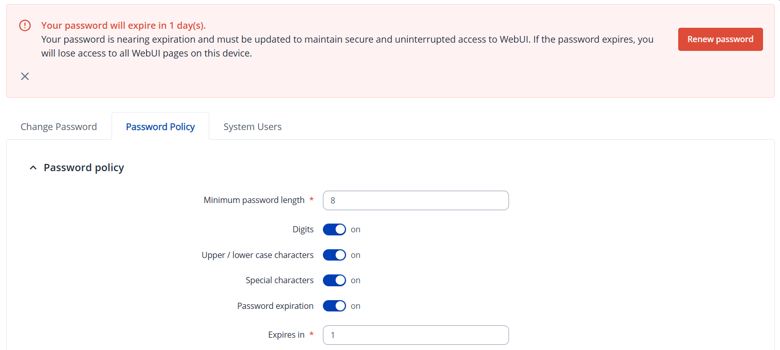

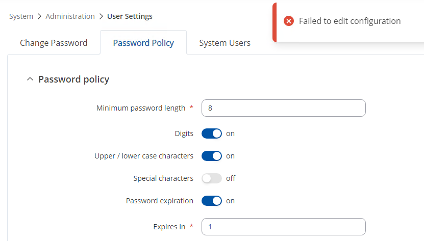

Additionally I have been trying to experiment with password expiry as a workaround in the even this isn’t possible, but it seems in the latest firmware password expiry is not working (see screenshot attached)
Is this user error or a problem in the latest FW? I believe I was able to set this in a previous version.

Could you please clarify this part of your request:
but upon first login of any user, password expires and user is prompted to select new password”

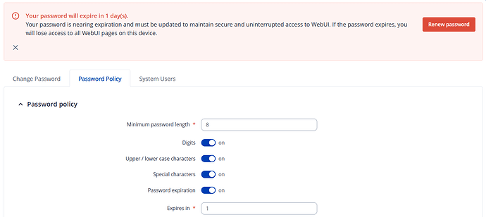

Do you mean for all default and created users (e.g., admin, test, etc.)?
With the current password policy and configured expiration, an additional user needs to be created to allow setting the expiration period (for example, to 1 day). In this way, after 24 hours, every user who logs in will be prompted to change their password — but not directly on the very first login. Instead, while logged in, the user will see a notification alert reminding them to renew their password within the upcoming day (or the specified period):
After renewal, the expiration period will not change automatically; it remains in place until a user belonging to the admin group modifies it, for instance, by disabling password expiration.

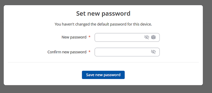

What I am hoping to do is take the logic for the default password handling as it exists in the factory settings and apply it to my own sw bundle.
As seen, I would like to prompt every user on their first log in to change the password from the “default” so every device has unique passwords for each user. I would like this to work at minimum for admin (in that case we would define the unique admin password and provision users after. It is important though that this is in the sw as provisioned, because we would need the network settings already configured. After setting this there would be no expiration.
Would this be possible?
Implementing a feature that prompts every user to change their password upon their first login to the WebUI would likely require a custom development project (CDP). For this, we recommend contacting your sales manager to discuss the options available. If you do not have a dedicated sales contact, you can then complete the Contact Us form on the page here.
